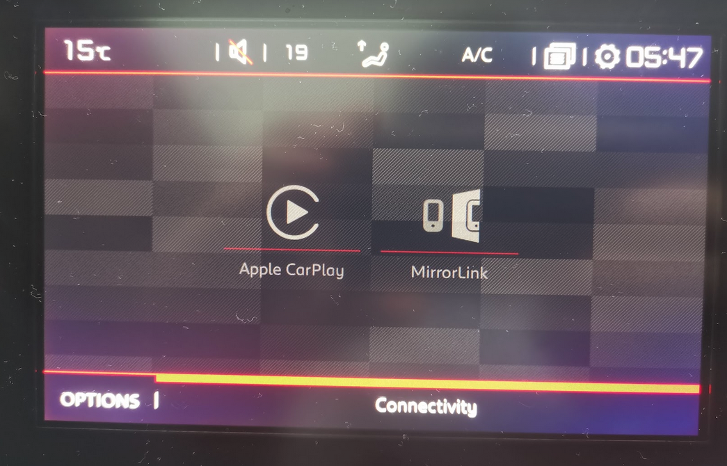

Hey guys, I have just got a C3 from 2017 and was very excited to try Android Auto with it, hower the option is somehow missing in my NAC unit...
There is an option for CarPlay and Mirrorlink (which is a legacy option for Android and does not work any more) - but no Android Auto for some reason (photo attached)
The car when I got it initially came with a pretty old (I think) 21.05.78.22_NAC-r0 firmware (which I believe is NAC Wave 2.1 unit?), I upgraded it to the latest 21.08.87.32 - but no AA still, even after the upgrade...
Digging through various forums and threads does not seem to bring any obvious conclusion - it looks like AA might have to be 'activated'(?) somehow, but it is unclear who exactly could do this and how. Citroen dealers I called do not seem to have any clue about it.
Any hints or ideas how to proceed would be very much appreciated.

It is not a cable issue for sure, the Android Auto 'app' is simply not present on the device at all (super weird, I know...)
The paper manual I got with the car does not metion it either (only CarPlay / MirrorLink), which makes me think it is some early release of the NAC unit, shipping without the AA feature?
I believe the car is one of the first 'next gen' 2017 C3s.
The VIN is as follows:
Since the firmware is the same as for others Wave 2.1 NAC units, it feels like it should be possible to activate AA somehow?

Tried a bunch of phones, Samsung Galaxy S20/21, Huawei P20, OnePlus 8, with different relatively modern flavours of Android (10-12) - none of these do much when connected to the car (the Mirrorlink icon gets enabled once phone is connected - but I don't think it is possible to get the feature to work in modern phones).
It really looks like my car got 'nerfed' somehow and the AA feature is just not present for some weird reason. Woudl be amazing to be able to activate it somehow....

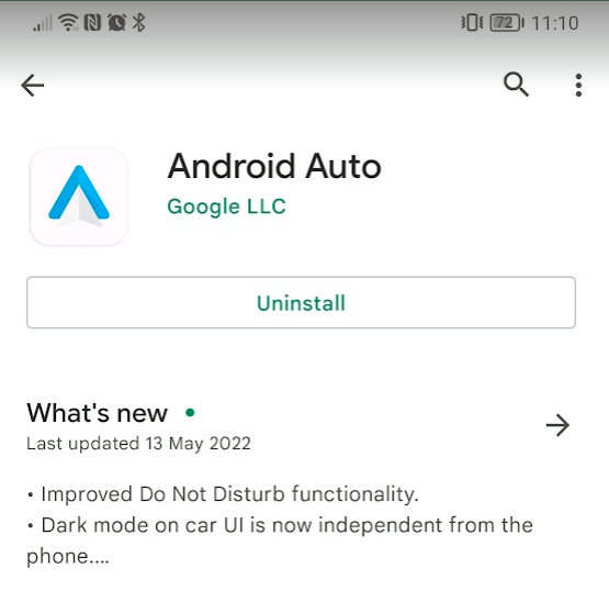

Have you also downloaded the Android Auto App from the Google Store?
To use Android Auto *, you must have a vehicle or car stereo installed after purchase, compatible with Android Auto, and a phone with Android 5.0 (Lollipop) or later.
Download the Android Auto app to your smartphone from the Google Play store.
When you connect your Android phone to the compatible vehicle or car stereo, your apps will be displayed on the vehicle screen using Android Auto.

Correct - AA app is installed on all the phones I tested with.

Indeed, tried quite a few cables, all have got this problem - it is like AA feature simply does not exist on NAC.
Bluetooth pairing works OK.
I am wondering if the VIN number I provided possibly shows any clues? Has anyone ever experienced a need for 'coding' / enabling CarPlay or AA on the NAC units (as per that youtube video)?
