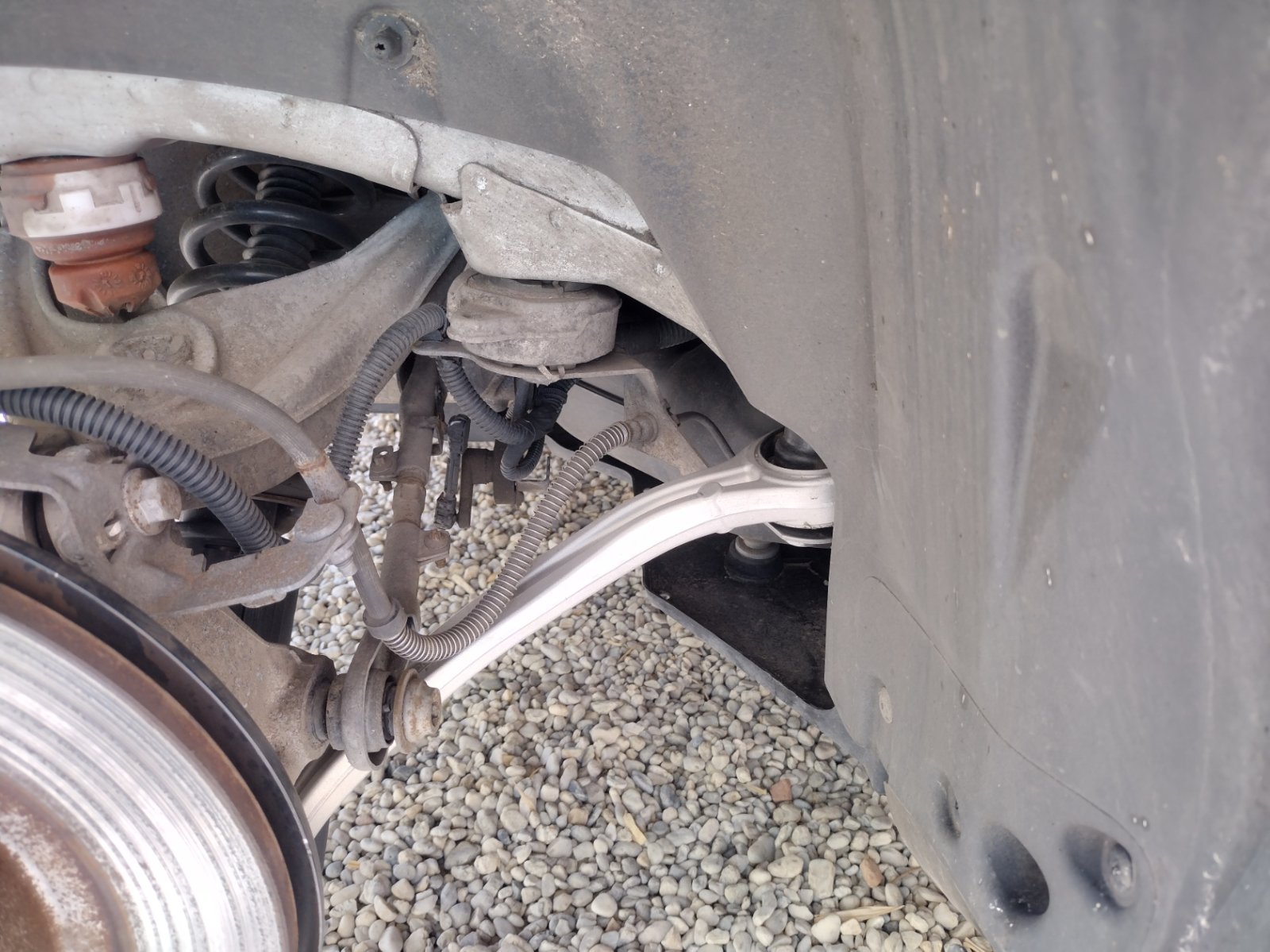

Re: DS7 Rear Suspension
This is what they changed. Needless to say clonks have gone!
IAN
IAN
