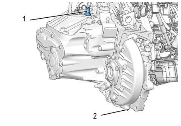

Correct, you should replace the same quantity as removed, but if not possible, a drain and refill:
Refill the gearbox via the air vent hole (1) using a gravity fed container with pipe.
The quantity of oil to refill after draining is 2.1 litres.
The oil type is:
ESSO 75w80 EZL 848 or
TOTAL 75w80 H 6965

Many many thanks Marc!GiveMeABreak wrote: 06 Jun 2022, 23:54 You have a BVM5 4X2 (MLUC) Gearbox
The oil type is:
TOTAL 75w80 H 6965
