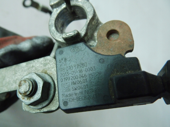

Re: keeping original radio on without ignition.
OK. Then it would seem I might have a Gremlin in mine.
The car is fitted with this Battery Charge status unit.
Can data from it be seen with Diagbox?
I haven't been able to get any info about the battery from it. Other than voltage.
When trying to initiate a battery test, Diagbox refers to a manual load tester and amp meter to be fitted to the battery. No dialog with the car.
Also I tried attaching a 20 Ah CTEK charger with maintenance function. But still the car initiates economy mode.
A: Do i have some form of early "in between" versions installed?
Or B: might it be corroded/bad connections for the Battery Charge status unit?
In which case I need to rectify it.

Out of curiosity where did you connect the negative connection of your CTEK?CVR wrote: 06 Jun 2022, 15:06 Also I tried attaching a 20 Ah CTEK charger with maintenance function. But still the car initiates economy mode.
CVR
- (Donor 2026)
- Posts: 20
- Joined: 08 Apr 2021, 19:56
- x 1
Directly on the terminals of the battery.
Hmm, you might be on to something.
Because the Battery charge status module is built into the negative terminal. Could it be as simple as a wrong connectionpoint?
C
C
I
Yes it could. Charger should always be connected to car body so that the battery charge status unit recognizes it properly.
But, there is a way to disable economy mode and keep the radio on as long as you want to!
With Diagbox, you can set the economy mode off to a "showroom" setting. This is commonly used in workshops when working extended periods of time with Diagbox etc, battery charger connected.
You can find the setting in BSI configuration.
