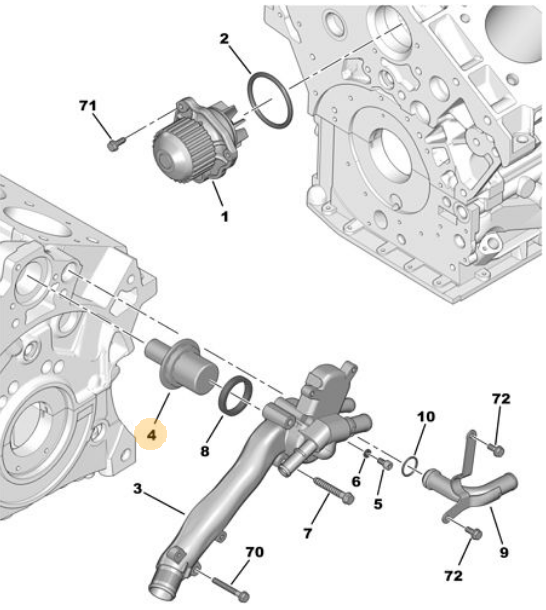

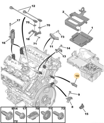

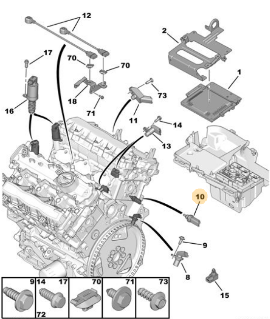

James - I've moved these queries out of parts requests and into a separate thread as you have several queries and at this stage are not part number requests.
The C6 has a build date of 4th November 2005.
1) Cooling Fan Relay:
2) Thermostat
3) Water Temperature Sensor
2) Thermostat

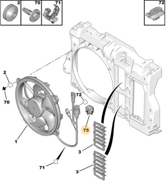

Maybe a new relay is in order? What is the part number of Item 75 please?

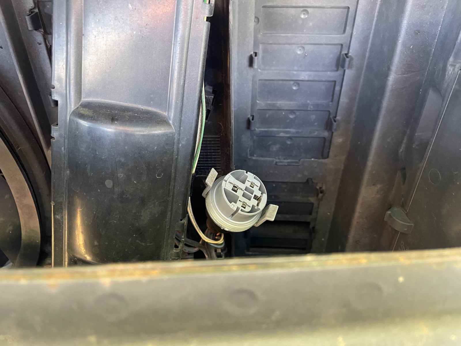

Hmm, I was expecting to find this under the fuse box but found a few chopped wires with some black insulation tape roof them. This may be original and as built but I’m now confused— especially as when I asked the garage about this last time they said that the Lexia could operate the fans fine. I’ve asked the other guy I know with a petrol C6 to look at his.
Is there a Citroen manual procedure for changing the cooling fan relay which would reveal where it is?
I bought the relay suggested, just need to know where to plug it in!

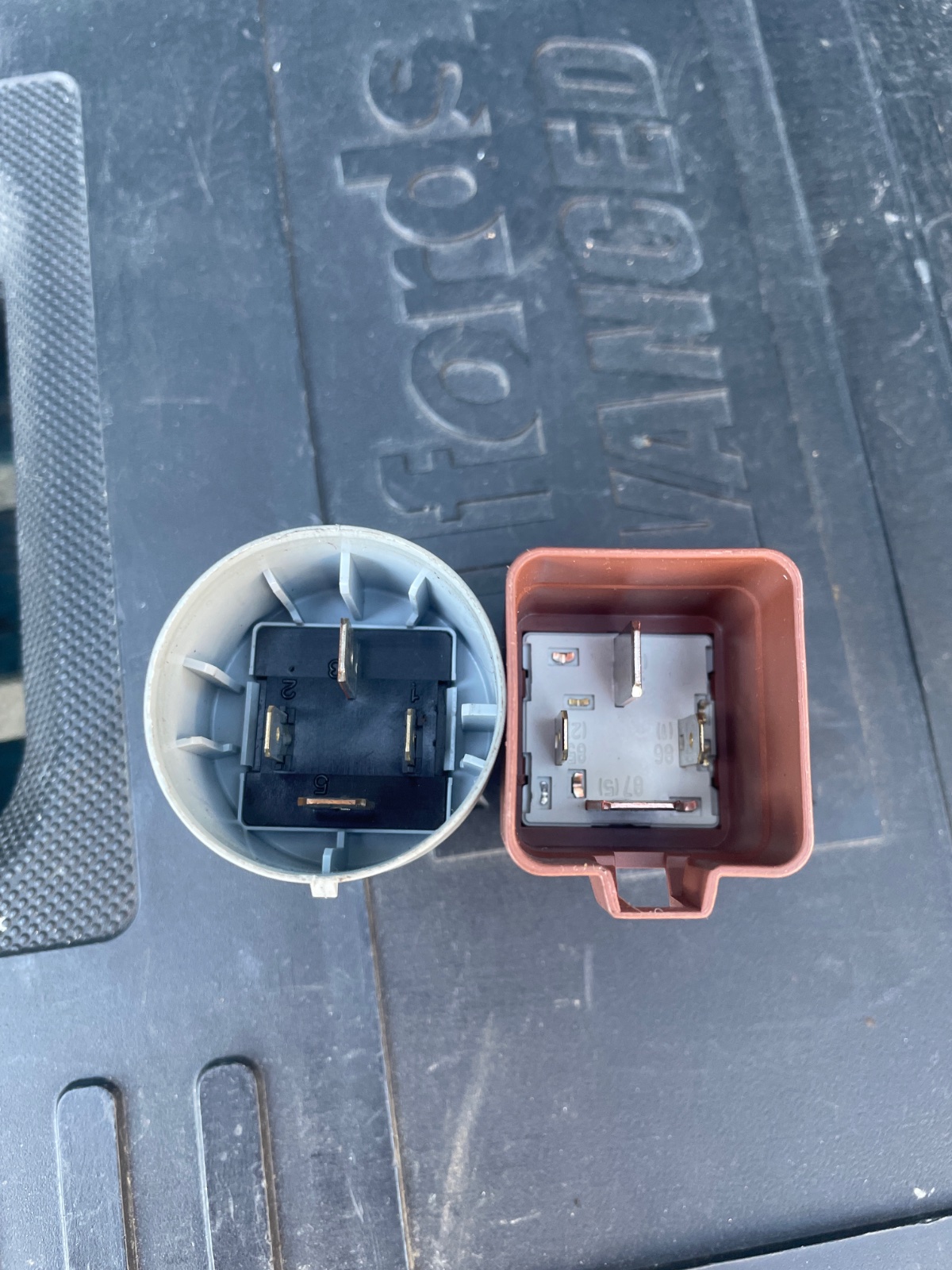

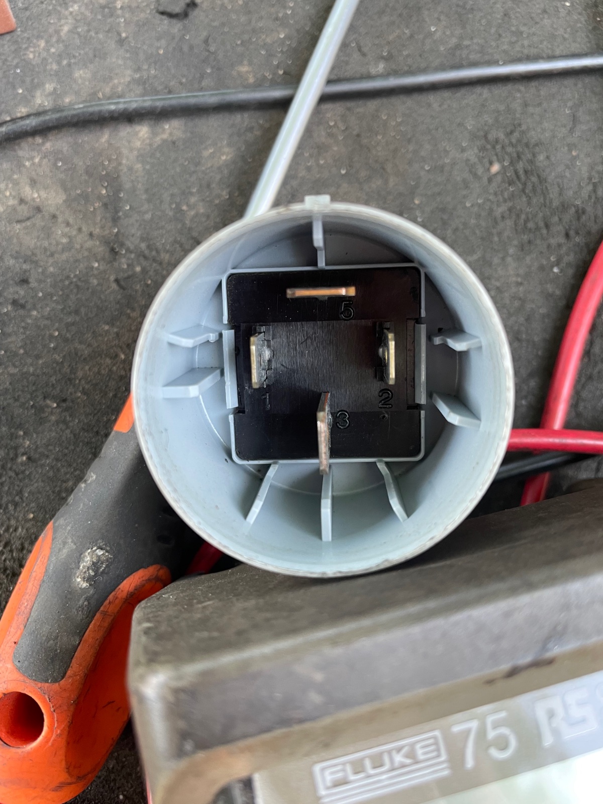

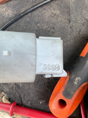

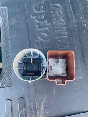

Relay is plugged in to the wiring that comes off the fan itself. The bumper had to come off to access all of this. If it was better designed, the top panel should have came off to allow easy access to the radiator gap.
The relay that I ordered from Citroen (6545XF) did not fit my original fan— original fan has circular plug, replacement relay is a square plug.
However, that is irrelevant as I tested the relay and it works fine. The fan, although not seized, is toast and does not turn when given 12V.
Therefore, please could I have the part number of the fan, item 1, please?

Is it 4 wires all cut at the same length? if so the may be spare repair wires, C5's & a few other Citroens have them but couldn't say for sure about the C6. If it is them you will find the other end of then somewher behind the BSI inside the car.jamescarruthers wrote: 24 May 2022, 14:58 Hmm, I was expecting to find this under the fuse box but found a few chopped wires with some black insulation tape roof them. This may be original and as built but I’m now confused—
Do you have a pic of the cut wires?

Looks like early (original) fan assy. uses the round relay plug and the later one uses the square relay plug.

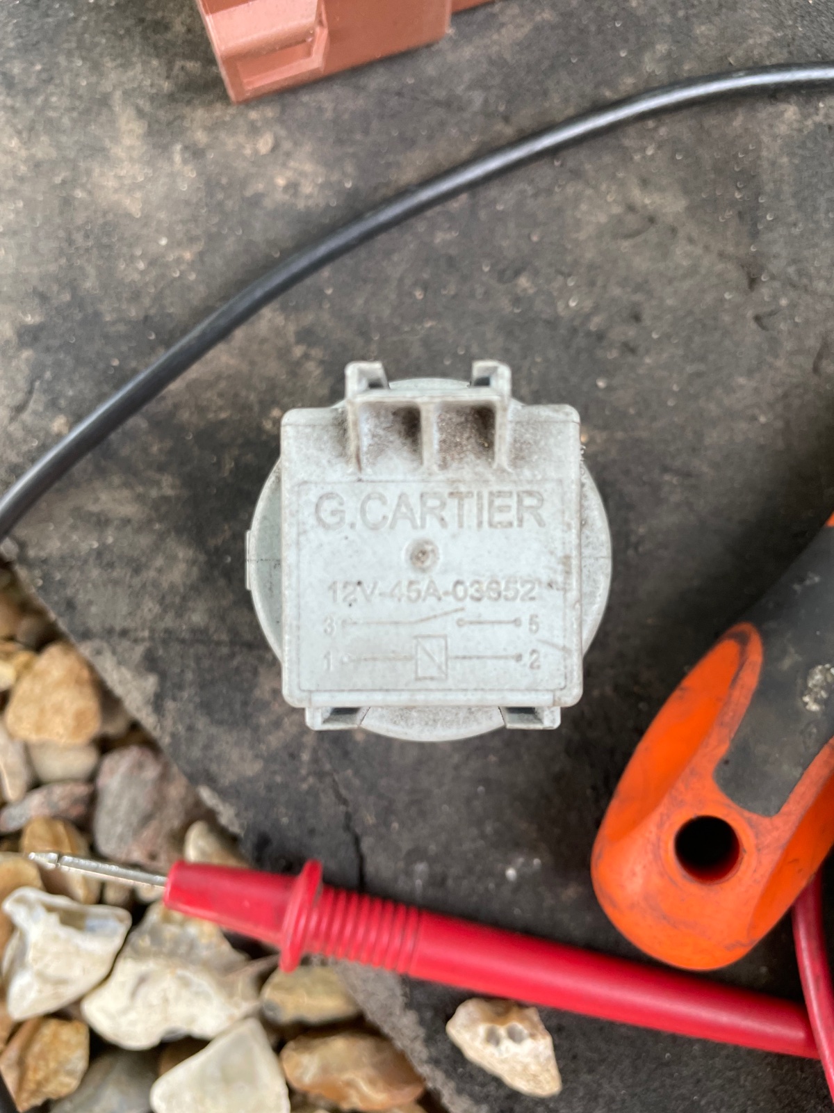

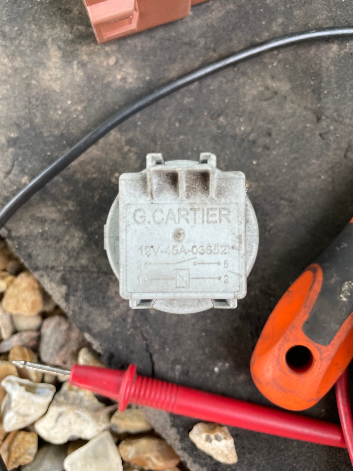

Original fit radiator and it’s round plug relay:

I didn't know Cartier made made car relays! That explains the price!.
