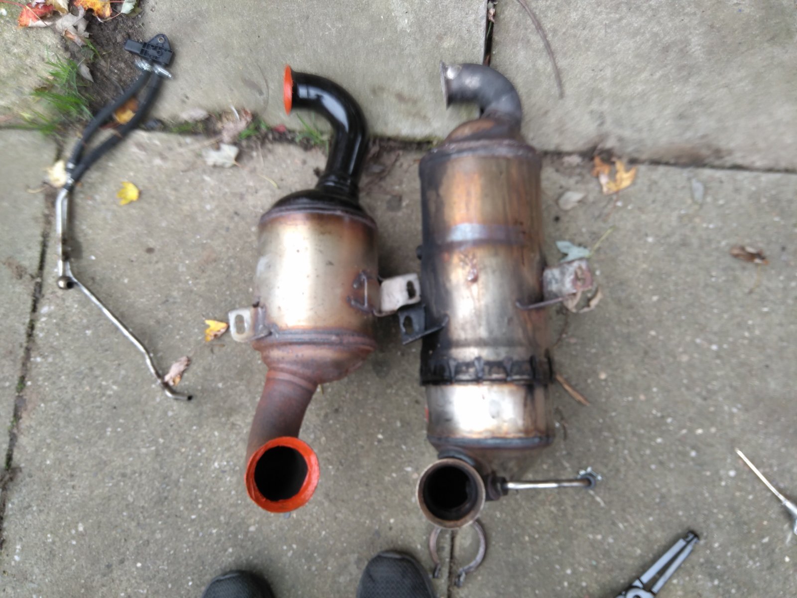

hi, I got somebody from facebook marketplace to come and do it who does remapping, I bought the 207 with faults and it had a blocked dpf, I bought a new dpf for it but when I dropped the old one out the cat had been removed by a previous owner, and the dpf had a hole through it. I put my new dpf on but it blocked within 200 miles, and that was because there was no cat to burn off excess deposits before they get to the dpf.
So I bought an older 207 cat only pipe to replace the cat/dpf pipe I had, its a straight swap, I fitted an EGR blanking plate and then had the egr and dpf [with additive etc] mapped out, I kept the power map the same because to have it mapped for more power, will always mean it burns more fuel, and I didnt want that.
cat , and cat/dpf only pipe side by side:

Re: 308 HDi emission fail
Looks very interesting and a much happier car by the sounds of things , blocking up after just 200 miles is a shocker !
Husky.
