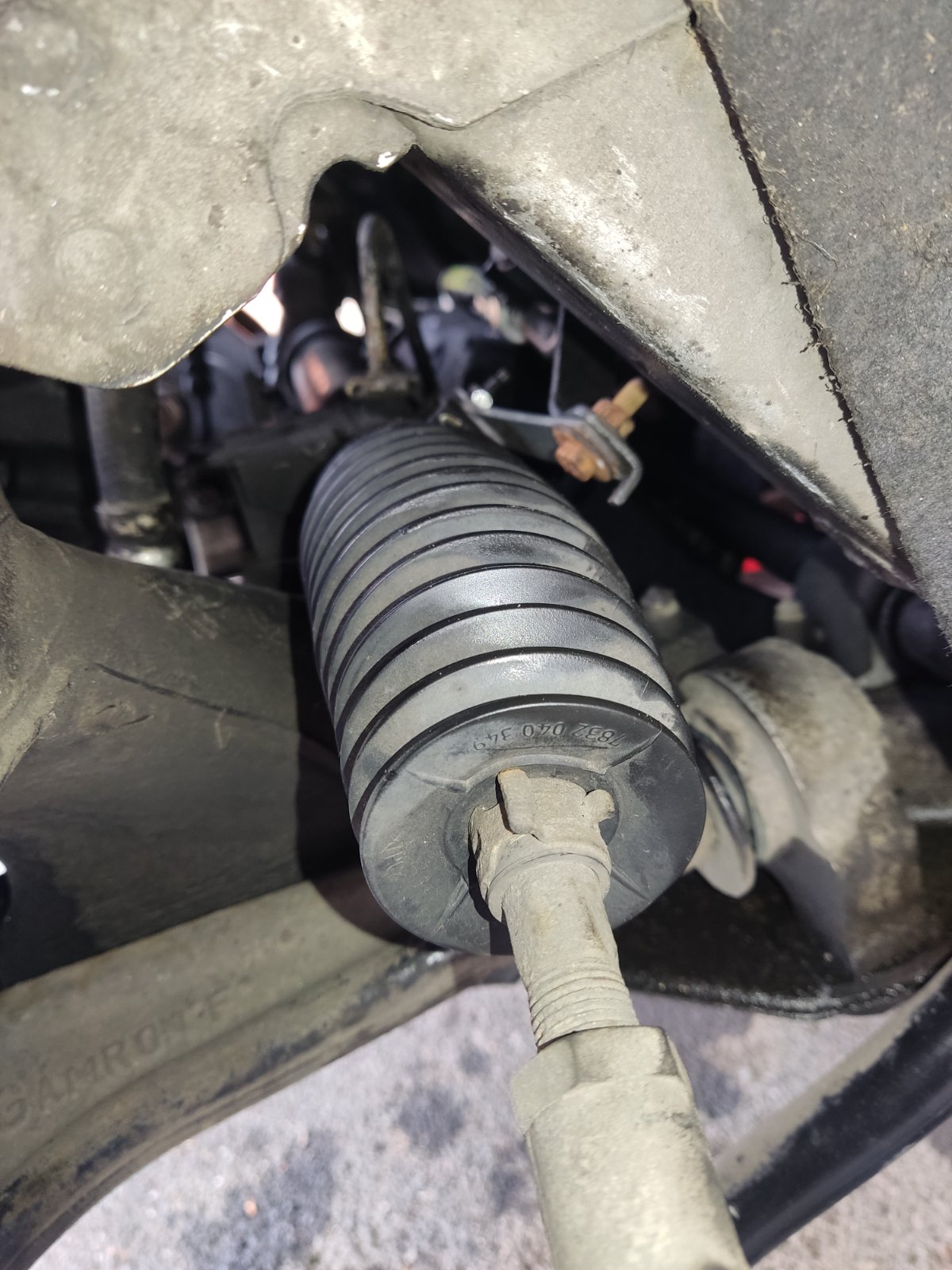

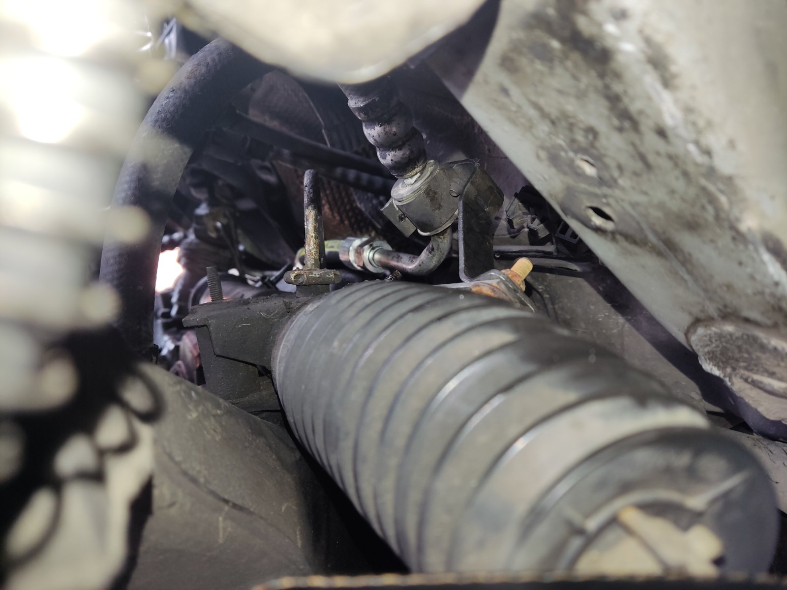

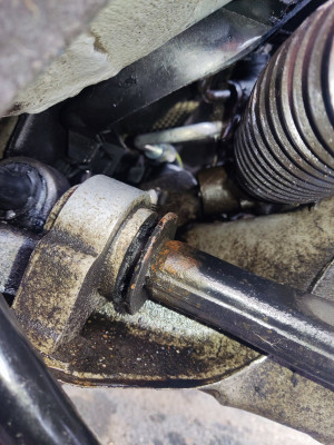

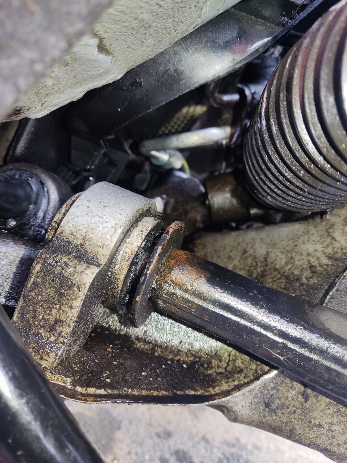

Not sure if this will help anyone or it's been done to death already but this is how I repaired it.
- x 6945

Haha yeah, although I don't remember so much swearing in Blue Peter, it's not the best job to do on your back on the drivewayGiveMeABreak wrote: 15 May 2022, 22:11 Well done - watching all those episodes of Blue Peter paid of no doubt!![]()
How are people normally getting around this problem? Is there a place that knocks them up as they're difficult to get second hand too.
