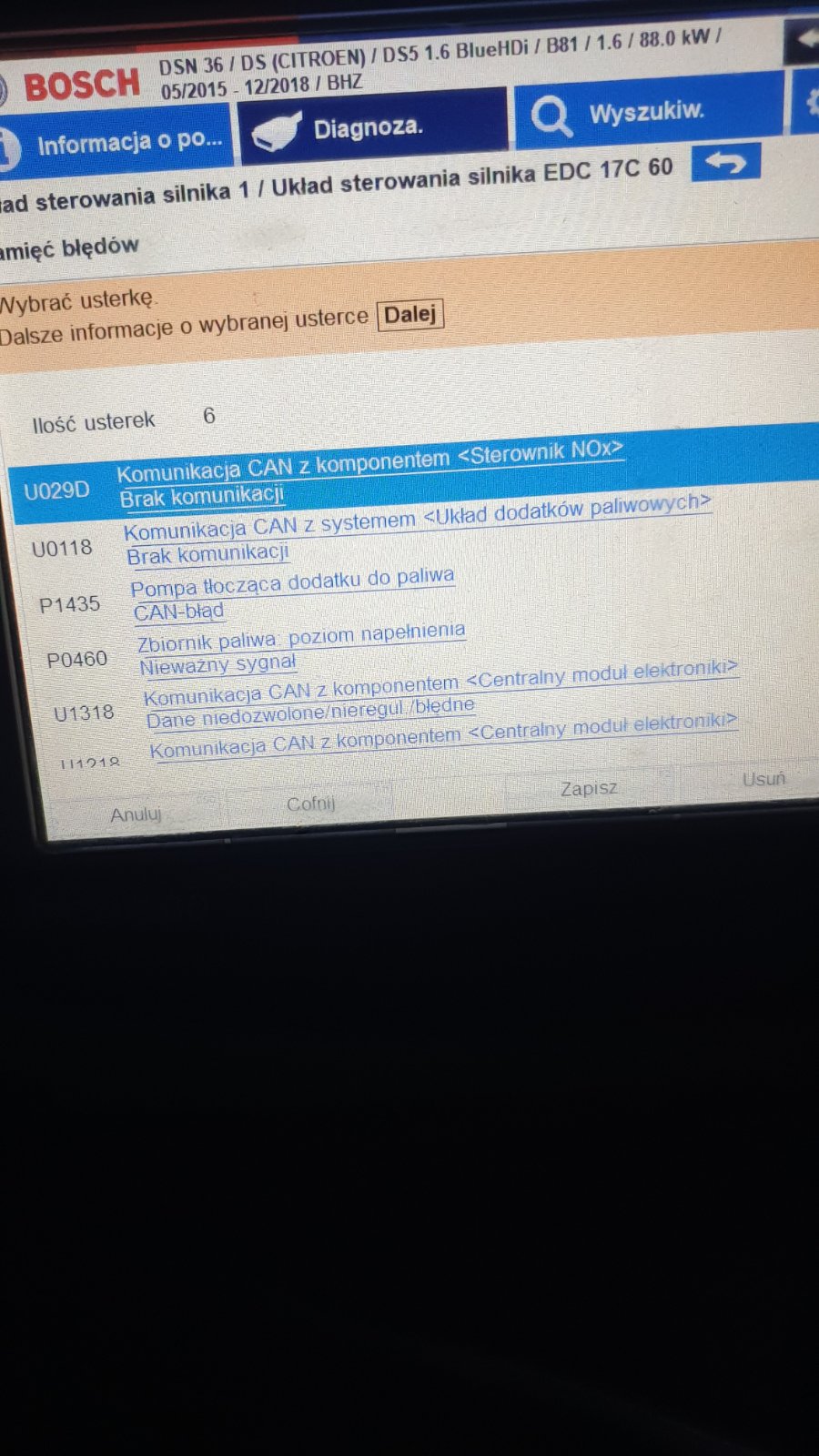

Re: U1318 86 code?
Hello I have DS5 with problem with nox probe and this part was change on new and OE. Aftet this I have next fault code u029d. I chec all electric connectors under the car and after this I have next errors u1218 and u1318 and this 2 are permanent. I can not delete this errors. Has anyone had a similar problem?
