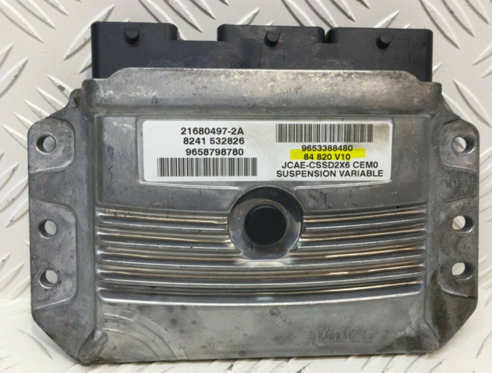

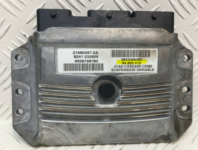

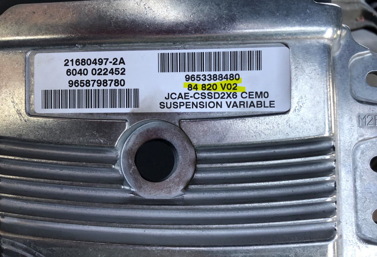

b) there are a few suspension ECU's that have the same part numbers but say V10 and not V2 (which is my unit) - see pic - any issues
c) do I need to reprogram anything to fit a donor V10 suspension ECU ?

I'd ignore most of those. You'll find that the suspension ECU can throw a wobbly when a diagnostic is being run on it and the car is not moving. It is common the C5 X7 (although some different codes) and are probably the ghost fault equivalents on your V6.
I know the coupe had AMVAR, and I thing yours does also. So the struts will have damper actuators on the top of each to provide one of 9 damper settings. You should also have a height sensor on each wheel (be careful not to remove those, as it will require setting the heights which is a pain.
Unless there is any specific reason, I would leave well alone. Some of the suspension ECU features may not be used and this could be why you are getting a configuration issue in Planet / Diagbox.

The part numbers are the same, but there are likely differences in software versions and possibly hardware internally.
One thing I do suggest if you are even considering replacing it, is to copy all the configuration of the old one first before removing it, so you can configure the parameters correctly on the replacement.
