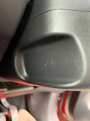

- x 6945
Re: Keyless entty
Yes for keyless entry and starting enabled vehicles (in this case I am using the C3 Aircross in the picture below), there is reader integrated into the steering column as shown below. If something were to go awry with the fob (say you dropped it and damaged the electronics or there was a fault with the vehicle system that detects the fob) then you would use the emergency mechanical key contained in the fob to open the door. This would probably set the alarm off, so you then place the fob against the electronic reader panel as shown below and press the start / stop button on the dash.
This would unlock the electronic steering lock and allow the car to be started in such cases.
Secondly the other purpose is when the fob battery is replaced, it needs to be initialised, so again after replacing the fob battery, you just hold the fob against the reader and press the stop / start ignition button ti reinitialise the fob.
If you click on the image, you can see the symbol more clearly
