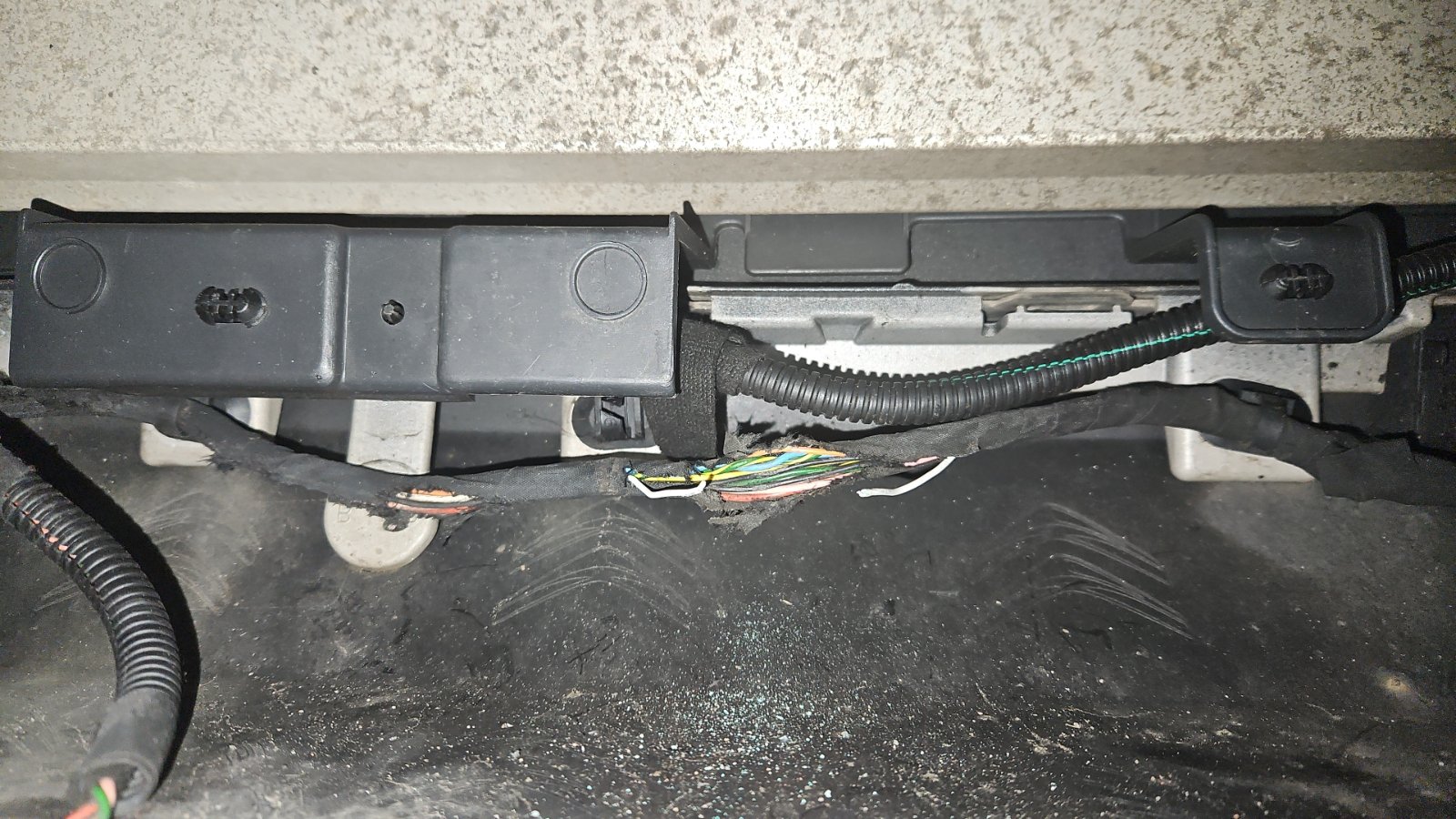

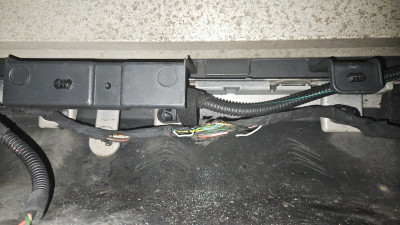

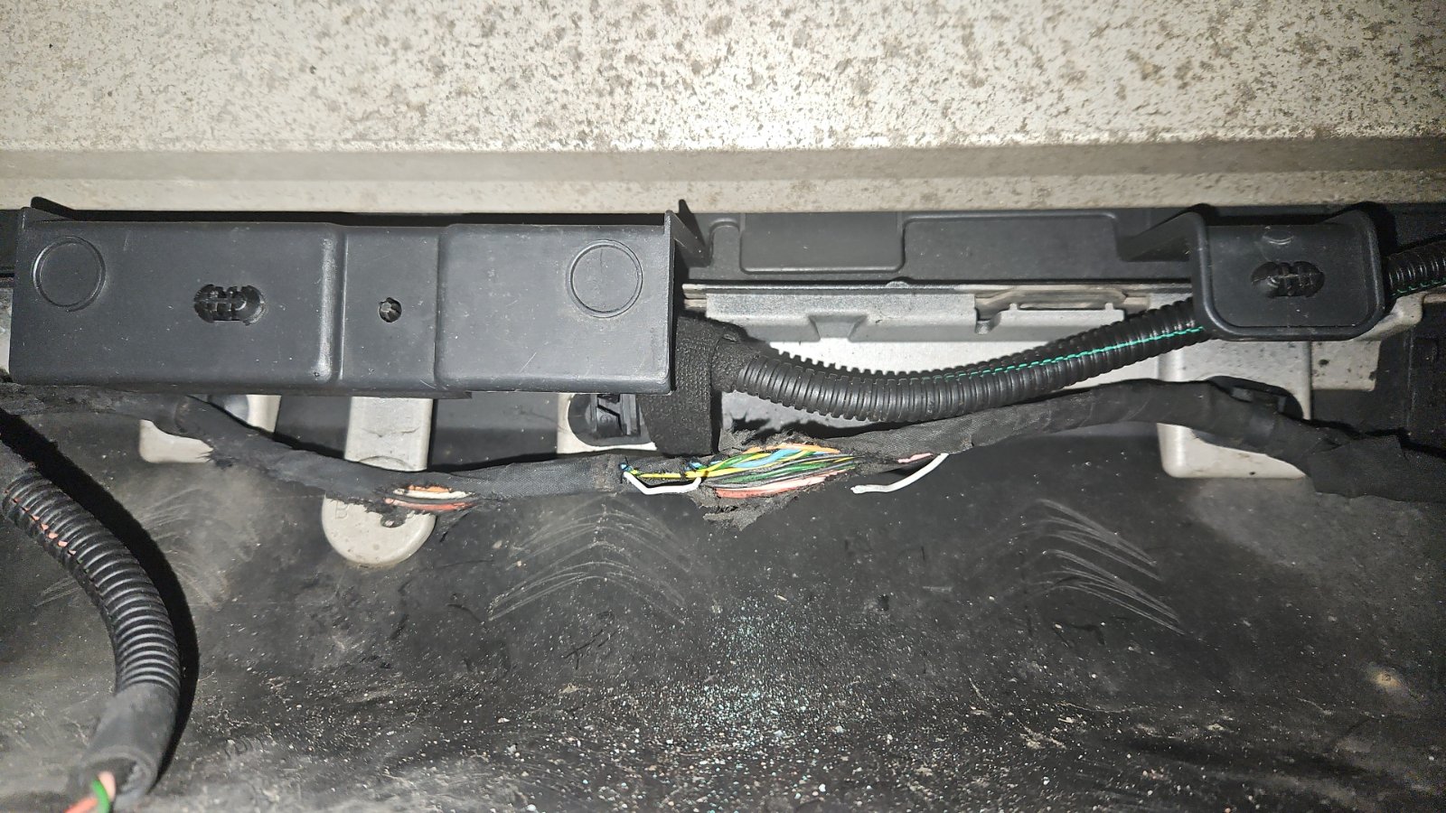

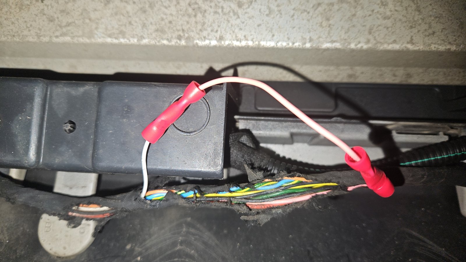

OK guys I had this problem on my wife's 2018 c4gp and managed to fix it as follows.....
Same fault on start up "Park assistance fault" flashes up.
I can confirm that this model needs to be started in order to activate the parking sensors. It cannot be done just by powering the ignition and selecting reverse.
Even although the fault is there the system will still send power to the sensors when reverse selected but will not give any indications on the display.
So with my wife sat in the driver seat I got her to start up and select reverse.
This allowed me to do the "tick test" at all sensors.
Only one was not ticking (rear middle right).
I swapped it with the middle left and the fault stayed with the original position.
I then knew that the fault was not a sensor but wiring to that position.
Easy con checks first.....
Looking at the wiring manual all pin 1's are linked to each other so I took the connector off the aft left corner sensor and con checked between both pin 1s......all good.
All pin 3s are also linked to each other and a similar check was done.... all good.
The tricky one to check is pin 2 on each sensor connector as each is a separate wire back to the control unit.
You could remove the connector at the control unit and identify the wire colour for the pin 2 you are looking at and con check from the unit connector to the sensor connector.
In my case it was a white wire going to this sensor pin 2.
I was lucky though....tracing the loom back on the underside of the car I noticed the loom wrapping was scuffed and just under the hole was ......yep the white wire covered in verdigris!
When I pulled gently on this the wire broke in half! (See pic one) I then crimped in a section of spare wire I had (pic 2) and that was that. Job done.
Started up and fault gone.
Hope this info may help with future diagnosis of the same problem (don't dive in and change a sensor if one is not ticking, swap it with a known good one).
