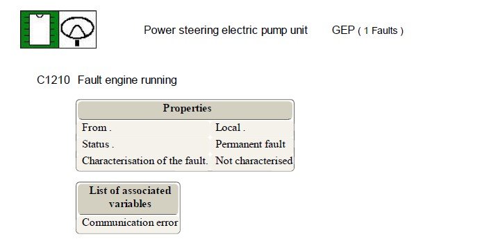

Update - after a Lexia scan I got this -
x 6950
Re: C4 Power Steering Quirk
Was this with or without the engine running when undertaking the diagnostic? It basically means the engine running signal has ceased whilst the vehicle is moving. As a safety feature the power steering ECU may then activate the power steering pump in backup mode if this is the case.
Unread post by gosnoid72 »
Hi Marc,
This was without the engine running. Is there merit in doing another scan with it running?
x 6950
Ignore that error for now - it's diagnosing the power steering ECU without the engine running. so is not getting engine running data.
Ahhh, I think I'll erase all of the messages and then run a full scan with the engine running and see what's left.
gosnoid72
(Donor 2022)
Posts: 39
Joined: 25 Apr 2022, 21:43
x 1
Ran a scan with the engine running and still had the same message.
