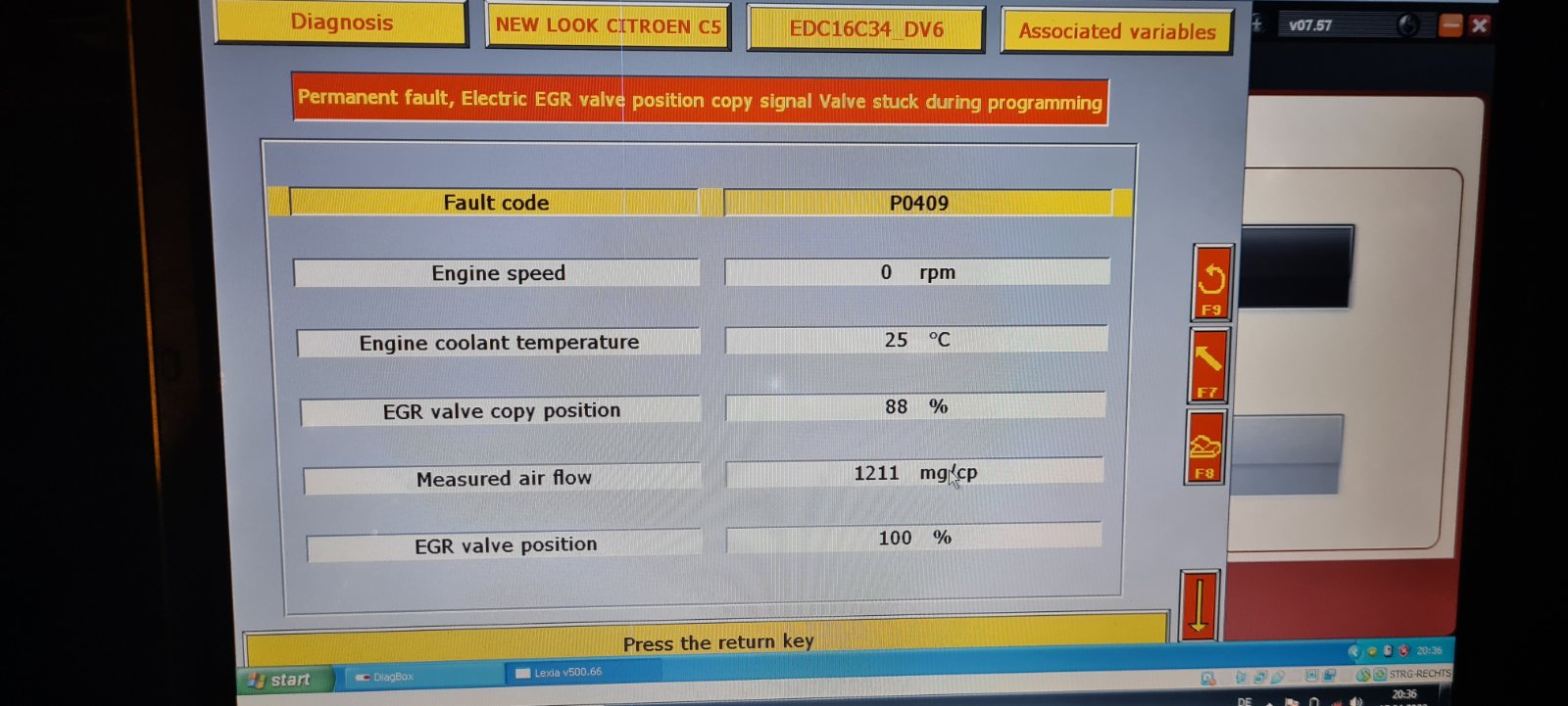

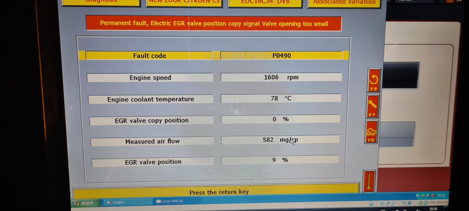

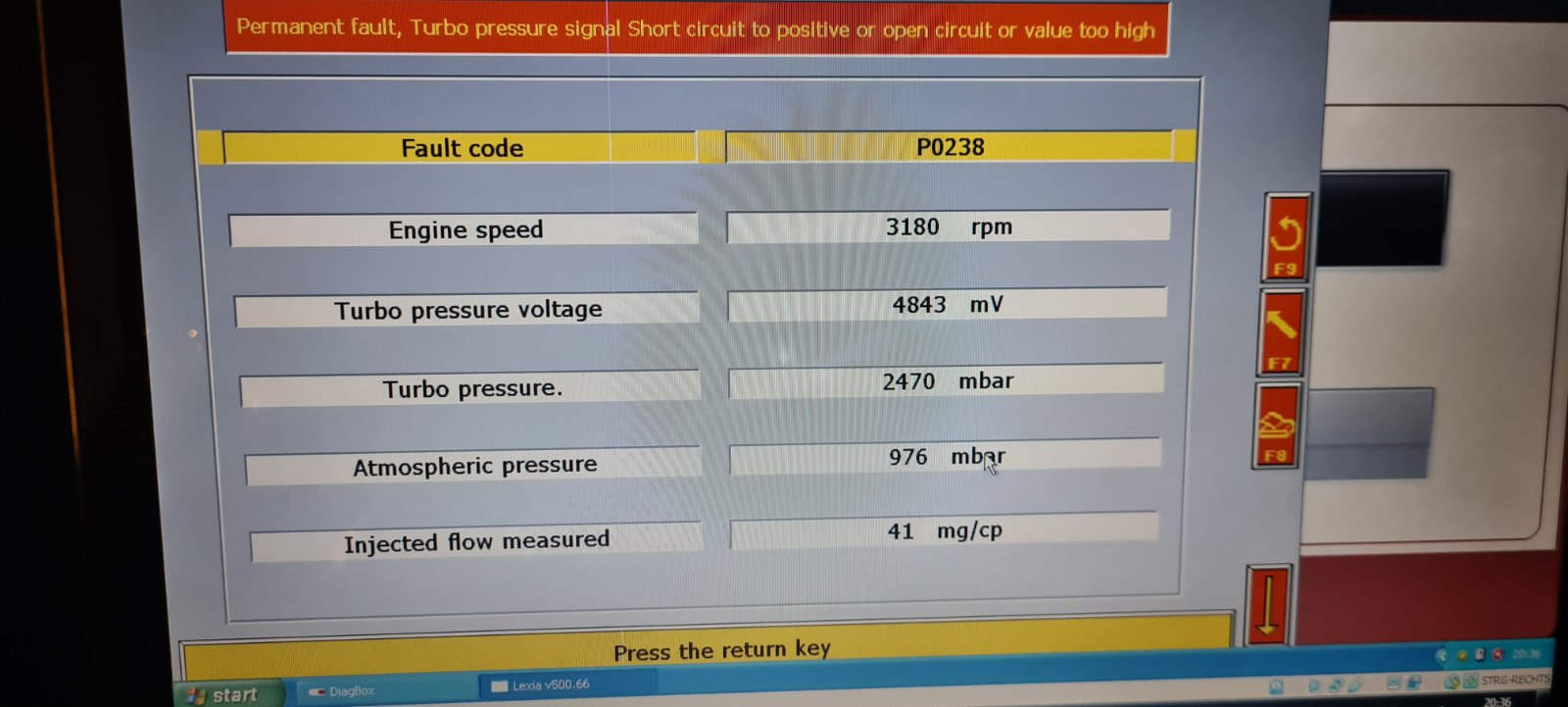

I have this problem with my Citroën C5 MK.II 9HZ from 2005, that the car thinks that the EGR is broken. It comes with the usual symptoms of EGR brokenness, such as, power drops, especially at around 1500 rpm and the engine doing wierd things. I let my local Cit-Workshop have a look, they told me that the EGR valve had to be replaced. Well, I did that, erased the faults with my lexia and I thought the problem was resolved, but it reappered. I cleaned the wire connectors to the EGR, replaced the air volume sensor on the air filter and also replaced the MAP-Sensor (which the car says was short circuiting, even after replacing). The problem was still there. The odd thing is that the valve itself seems to be working, because there is only little carbon buildup in it, also when driving the board computer shows, that the avarege consuption is approximately the same as Citroën claims it to be with everything working. I performed a BSI reset with lexia via the PDI. Seemed to be working after it. Power, drops only occured very rarely, almost non existent. Today i started the car and then "BEEP" the engine check light goes on again: "Exhaust sytem defect". Like bruh, I just fixed it. Did anybody have this problem before? Do I have to invest hundreds of euros into repairs? I bought my car with a blown turbo btw.

Those are showing as permanent faults. What happens if you try to clear them, do they go away and come back again?

Re: C5 II 1.6 HDi Exhaust system defect
After i clear them, the engine check light and the fault warning goes away, but if you drive for a little bit it comes on again and the power drops, aswell as the rpm fluctuations are still there while the light is out.
