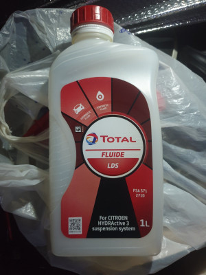

I am a little scarred because I purchased the car from someone for about 5 months ago and tomorrow I managed to check the LDS fluid reservoir. But, wait: on flat surface, I set to the top heigt, then to the bottom height, at cold of course, removed the reservoir cap and see the fluid between the markings A and B, but guess what? no fluid. So, I topped up the reservoir with LDS Total, the entire canister of 1 litre and no avail of the fluid between the markings.

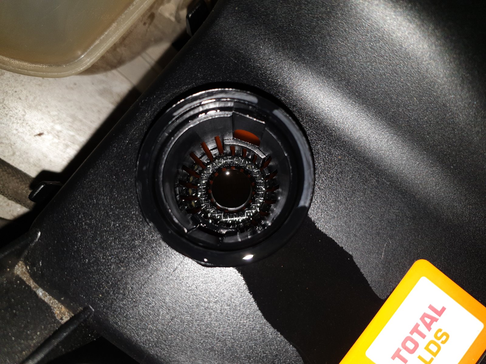

I read your replies on the subject on other topics and I knew about the markings but I wanted a better answer because ... today I managed to set the fluid level at the max mark finally but I filled another litre, so in total it went full 2 litre canister for the level to ve at the Top B mark. :-(
Is there any problem that I should worry because of the system running without 2 litres from a total of 5.3 for the past 5 months (or who knows, maybe more) ? :-(

I would run the suspension from full height to low height several times (which would help to move any trapped air to the reservoir and then out), followed by turning the steering from full lock to full lock (WITHOUT pausing at the locks, as this will strain the pump) for the same reason.

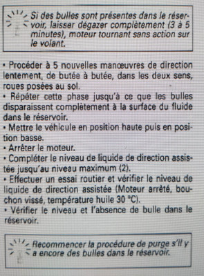

Hell Razor5543 wrote: 19 Apr 2022, 19:09 I would run the suspension from full height to low height several times (which would help to move any trapped air to the reservoir and then out), followed by turning the steering from full lock to full lock (WITHOUT pausing at the locks, as this will strain the pump) for the same reason.
Just like the french manual sais, right. Thank you for the reply! :D

secarianurazvan wrote: 19 Apr 2022, 18:52 Thanks a lot for the reply, Admin!
If you have'nt felt any strange choppy/noisy steering, i wouldnt worry too much.
The power steering runs out of fluid first.
