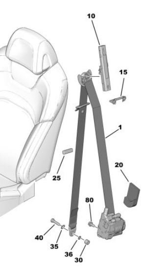

Not sure how this will cure the issue - as the seat belt reel is bolted at near floor level behind the side trim!
At most you will only be pulling the already exposed (behind the side trim) portion of the belt through into the cabin. Any cleaning or silicon isn't going to get anywhere near the reel housing.
I think it's likely a matter of the tensioning in the belt mechanism that is becoming lax over time. If it worsens, then a new belt will be needed.
