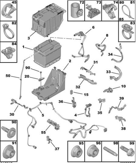

Can someone please send me the instructions on the removal of the battery on my 2016 2litre model. It will save me going to night school on the topic. I think my next car will be a pre 2000 model of something without all the fandangos on this car.

There isn't a guide for this Don, the normal battery is shown below:
Just be careful you don't touch anything to do with the ultra-capacitor / Energy Accumulator battery for the stop start system (which should be hidden out the way somewhere behind the front left wheel arch if anything like the C5.
This is the standard guide I put together concerning battery disconnection / reconnection, but this is not an actual battery removal guide, more so to prevent electrical issues.
BSI Reset / Battery Disconnect / Reconnect Procedure

Thanks Marc, that is excellent help as always. All I need to do now is determine whether a Varta battery is worth the extra “hard earned”.
