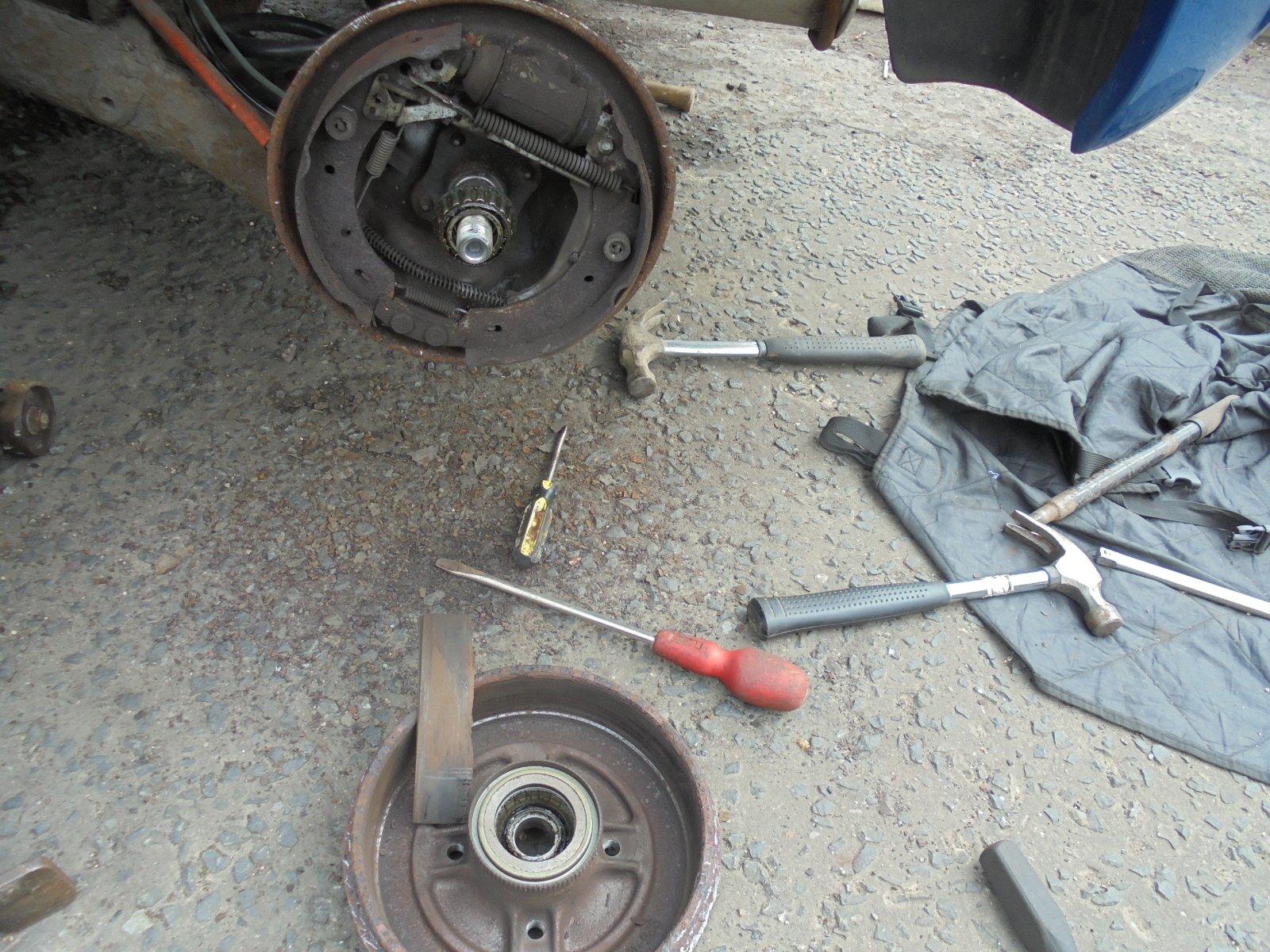

As expected a delaminated brake lining and 2 hours before the drum gave up the fight and came off.<br />Random arsenal of tools.  The genius of the claw hammers surprisingly proved the most effective.

RichardW wrote: 13 Apr 2022, 21:43 Well done Neil. Drum brake work is not my favourite!!
Thanks Richard after struggling to get the drum off, no doubt hampered by the lining which had gone AWOL, I actually did go and call the cavalry...well took it to the nearest garage, because I thought with the tools I have its going to take all day and might not work. I have no sort of puller. They were pretty good, I had the parts and they reckoned £64 if it took them an hour. I asked them when they could do it, and Saturday was the answer. So I decided to give it another go, still no good until I started wedging the flat of the claw hammers in between the lip on the drum and the backplate and following it right around the drum circumference. It was a prizing action which slowly got the drum moving in an outwards direction.
