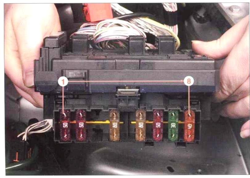

Did the master fuses get checked i.e. the ones under the under bonnet fuse board?
There are three wires to the pump two thick, a supply and earth and a thin signal wire, if you can get access to them (open the loom where it goes down at the front corner) and run a wire from the battery + to the pump + i.e. by-pass the usual run then apply 12v to the signal wire, needles pushed though the insulation will give to access for temporary connections, the pump will work if it's not faulty.

Re: C5 Mk3 suspension reservoir overflowed & car won't rise
The pump fuse is number 8 ... 40 Amps.

Recently MY C5 threw me a 'suspension fault' wobbly. I eventually found that, although all of the fuses were fine, enough tarnish had built up on the fuse blades to stop the pump working (no power). I cleaned all of the fuse blades in the engine bay fuse box with an abrasive rubber block, sprayed contact cleaner into each fuse socket, and that sorted out the problem. In order to keep the electronics 'happy' I went through the BSi reset procedure, and cleaned the fuses while the battery was disconnected.

Further update - thanks to the help you have all given us, the indy garage realised that he had missed, what sound like, the master fuse. It now keeps blowing the fuse and it's been decided that the pump is wrecked. Costs to fix a new pump range from £700 for a second hand one, to £1700, for a new Citroen one. The car is now 14 years old, with little retail value, unfortunately it may be time to think of a replacement as it's cost my son quite a lot of money over the past 12 months.
