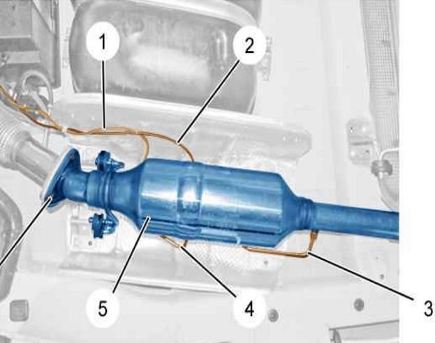

So it basically it still thinks the filter is overloaded, so I would check the gas temperature sensors are ok (1 & 2) below. I'm assuming the DPF pressure pipes (3 & 4) below are ok too?
The exhaust gas pressure take-off tubes (3), (4)
The exhaust gas temperature sensors (1) , (2)
it is still detecting an overloaded particle filter. When you replaced the filter did you tell the engine ECU that you had replaced it?
