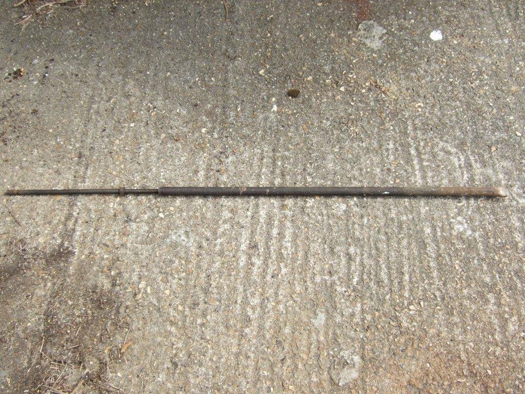

Its should toe in a little obviously yours is toeing in to much. It varies from car to car but its generally parallel to one or 2 mm toe in. I have used this for tracking for 40 - 50 years.

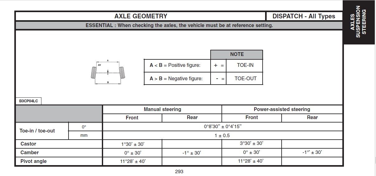

wheeler
Posts: 7930
Joined: 21 Sep 2002, 19:07
x 1055
Re: Wheel alignment info for Expert
Unread post by wheeler »
For a Dispatch but its the same thing.

Aha. Cheers. 1mm+0.5. So the ~5mm I've currently got will be 'quite bad' then.

OK. I bought a s/h trackace on ebay which arrived remarkably quickly, so I've adjusted it to the above spec. It was at 1 degree, which is a long way from 6 minutes. I'll need to free up the other side if I want to centre the steering wheel - but that's very much optional. I can get the tracking to spec with just one side movable.
