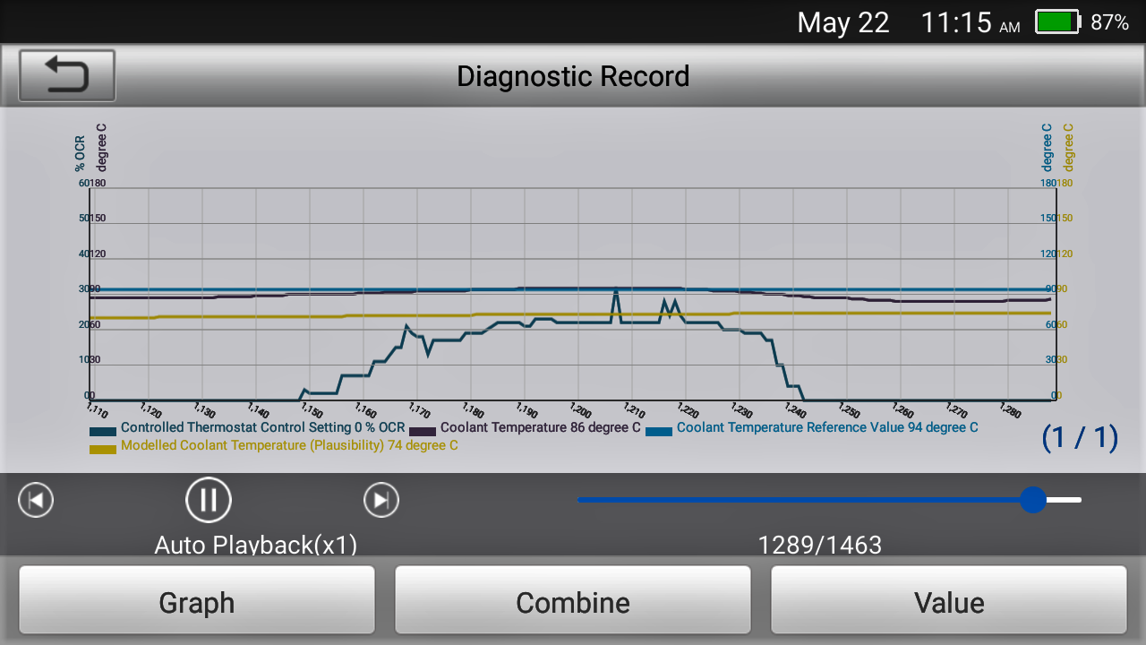

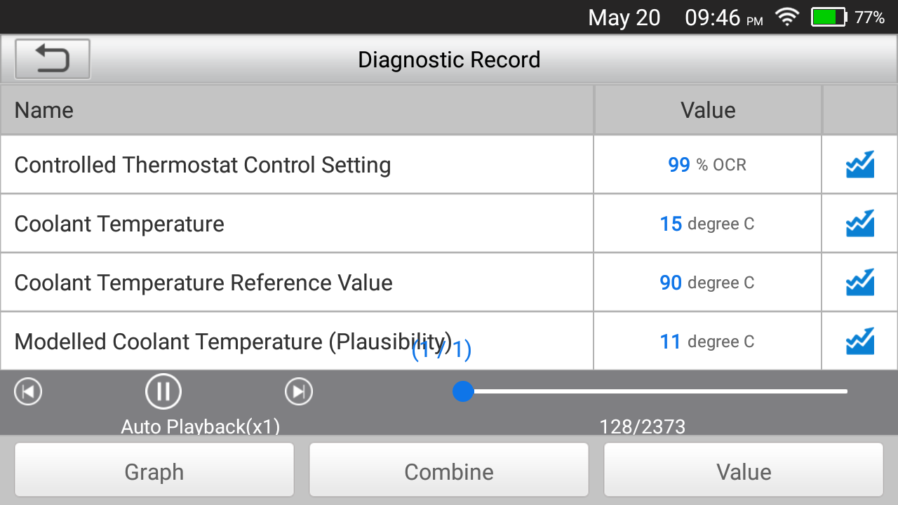

On my next DS5 outing I recorded the following temperature data- I used my Launch reader rather than Diagbox because my laptop battery is a bit doubtful.
Controlled thermostat control setting % OCR (what does Optical Character Recognition have to do with this?)
Coolant temperature ºC
Coolant temperature reference value ºC (I presume this is what the ECU is aiming for?)
Modelled coolant temperature (plausibility) ºC (is this a backup for the ECU in case the temperature sensor fails?)
I cannot download the actual data from the reader, just screenshots. The following was shortly after starting out, and I was surprised to see the controlled thermostat setting at 99% when the coolant was only 15C.
The next shot was when the engine was warm.
All the temperature data looked quite smooth, but not the Controlled thermostat settings, which maxed out at 30%.

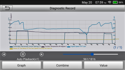

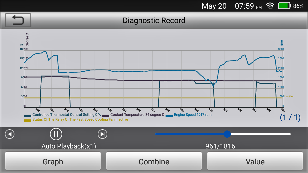

Next trip I took my 207CC VTi and had a slightly different choice of variables. I chose:
Engine speed
Status of the relay of the fast cooling fan ( I should have chosen Slow fan)
The values for the controlled thermostat for the Peugeot were much more regular and reached 100%.
What am I looking at here – a control problem with the ECU? My only consolation at the moment is that you can never have too many cars when trying to track down problems!
Engine speed

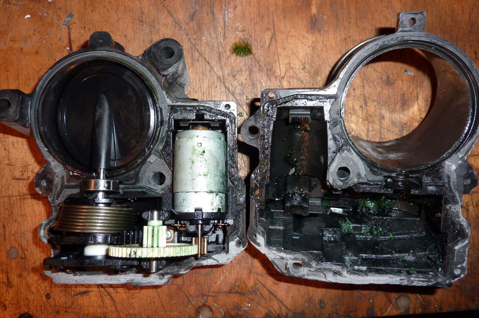

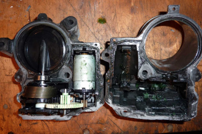

I had a spare throttle body from a 2103 BMW 118i that had the same part number and after some considerable effort managed to exchange them. The codes P1153 and P3014 have now been cleared and have not come back.
Who would have thought that fault codes associated with the throttle body and the radiator relay actually meant what they said!
I opened the case of the offending throttle body and found no obvious mechanical problems, like stripped teeth, with it.
