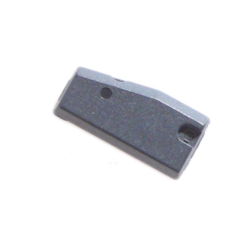

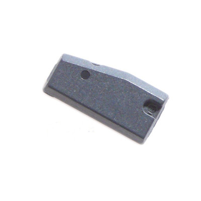

Can you take a picture of the 'Butchering' you have done so we can see what you have.
The chip inside the non remote key will look like this pic below.
