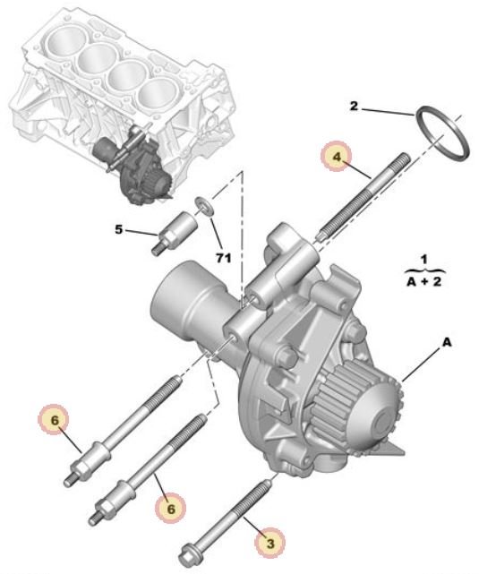

Gents, having a nightmare here. Could someone tell me the head size for the 3 waterpump studs please? I'm guessing E7 because an E6 is too small and an E8 has too much slack for my liking. If I chew the heads up it could be engine out to repair them.
Just want to confirm this before I buy one. What a ridiculous method to mount a waterpump.

It is an E7 and the exhaust manifold is almost in the way for the top RH stud so a special adapter needs conjuring up.

I think you have it now, but for reference:
(3) is the MUL Flanged Screw, DIAM 8X125-80
(4) is the Water Pump Mounting Stud, 8X125-15-76
(6) is the Pillar Screw, (no sizes given, but part 1201J3
