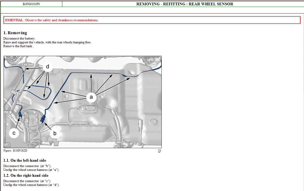

So, have the ASB/ ESP error come up (on and off)
Diag says C1325 left rear speed sensor aka ABS sensor faulty
Took the wheels off and the ABS sensor cable was a bit so so (eg 18 years old in the rain and wind etc )
Look at the Peugeot instructions and they said take the fuel tank out
Given mine was 3/4 full, that would not work for me
If you take the three bolts out and support with a jack you can pull the old ones out (tie some string to them first and pull the new ones thru)
The connector are in the fuel tank entry under the driver side passenger seat - ps you will probably break the tabs pulling the cover off )
All up took around 1.5 hours and so far no ABS/ ESP errors
Peugeot instructions and wiring diagram under car
