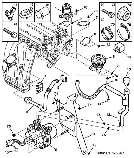

My thoughts there John make me think of a sticking EGR valve if the engine is fitted with one. When the engine is cold and an EGR sticks open it causes a drop in combustion temperature and so less efficient burning of the fuel. Likewise as the engine warms if the valve does not operate correctly it can severely affect the mixture signals sent to the ECU resulting in wrong adjustment of the mixture. If it does have one I would advocate a good clean and check the pipes for leaks Good luck
- x 6956
Re: C5 Mk1 1.8 Petrol - Various
There's no EGR valve on the petrol C5 engines Mick.

Mine does somehow and I've disconnected it years ago because it was annoying me.
It always indicates ‘antipollution fault’ but that doesn’t annoy me.
No MOTs here, they just want about 300 GBP per year to keep going.
2002 C5 2.0i AL4 240,000 km 76372389
- x 6956
I should of been more specific, the standard 1.8 petrol doesn't, unless it's the EW7J4 and specifically specified with "EGR" + "Pulsair" Air Injection.
