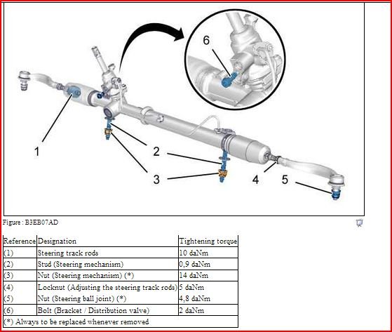

My newly fitted steering rack had gone loose! I don't think the garage tightened the 2 fixings properly (after wrecking the rack I supplied them)
Mentioned in this blog: viewtopic.php?&t=70118&p=712279#p712279
But I could do with finding the torque setting as soon as poss.
I've re tightened them but don't know the torque they are meant to be. It's there supposed to be threadlock?

Ok I've torqued it to 130 Nm for now and will leave the v undertray off for retorque

Graeme,
I think that’s about right
Kenny
Kenny

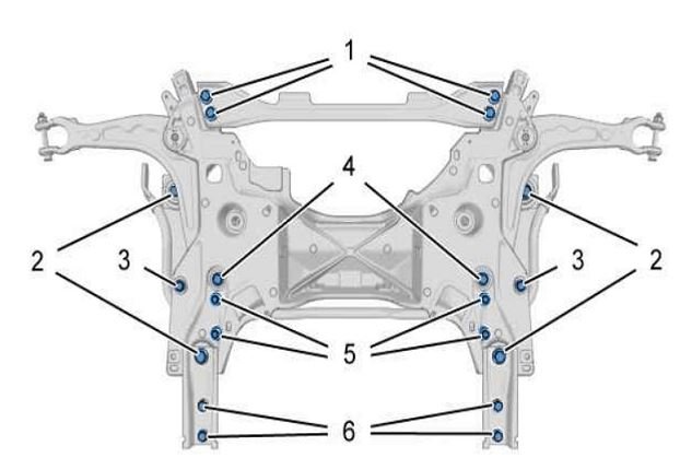

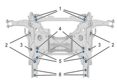

Just seen this, here you go:
CAUTION: The "Low Friction" bolts (or nuts) (1), (3), (4), (5), (6) are only for single use and must always be replaced. All re-use is prohibited (risk of breakage). The bolts (or nuts) removed must be thrown away.
| Reference | Designation | Tightening torques |
| (1) | Bolt (Stabiliser bar / Front subframe) (*) | 12,5 daNm |
| (2) | Bolt (Front subframe / Body) (*) | 14 daNm |
| (3) | Bolt (Lower suspension arm / Front subframe) (*) | 6,5 daNm |
| (4) | Bolt (Lower suspension arm / Front subframe) (*) | 11 daNm |
| (5) | Bolt (Front anti-roll bar bearing / Front subframe) (*) | 4,5 daNm |
| (6) | Bolt (Yoke / Body) (*) | 10 daNm |

I thought he’d want the subframe as they loosen that to do the rack.

I was looking at that wondering! Ha thanks.
So, 140 that's great thanks

Ha, now I'm thinking I'll have to check ALL of these. I see they're all single use and nine of mine looked new so I think they've reused all of these.GiveMeABreak wrote: 18 Mar 2022, 23:23 I thought he’d want the subframe as they loosen that to do the rack.
Graeme M
- x 6950
Re: C5 x7 steering rack mounting stud torque
Yes, they're very specific on this.

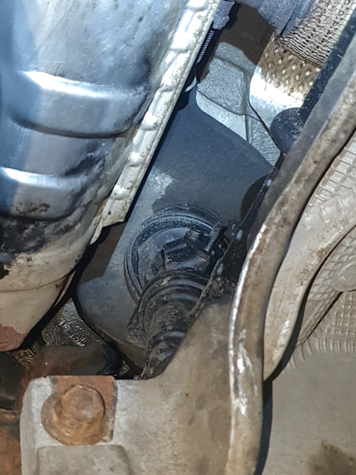

The loose steering rack is so far holding out and the symphony of knocks from the front end are now all but gone save for a minor rattle that I think are the drop links beginning to show wear.
While I was under the front with the undertray removed to tighten the rack mountings I took the opportunity to snap a shot of the new steering rack in place and the modified rubber CV gaiter that covers the weak point at the steering pinion valve.
You can see in the picture how the gaiter covers the pinion valve housing completely and then goes through the aperture in the driver's footwell and is held on the inside by the large rubber bung that closes the aperture. The CV gaiter it held tight around the edge and completely seals off the pinion valve and the troublesome cardan shaft that rusts so badly. YOu can even see here that there has been water spray that has hit the CV gaiter instead of the steering shaft. I really hope this CV gaiter cover is the solution I'm hoping and that this solves the problem of the C5 steering rack.
I think a few others have done similar mods but over a few years back - any reports now on how it helped?
