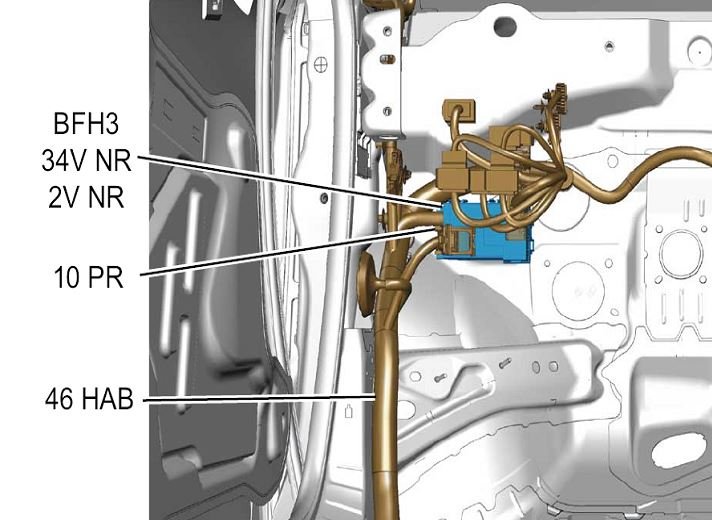

I don't think it will be the fuse otherwise the other mirror would not work, but these are the fuses in the cabin
F4 is the fuse for the driver's control pad that controls the mirrors
F2 is the 10A Fuse for the Heated Element of the Mirrors
The fuses are here in the passenger side behind the govebox:

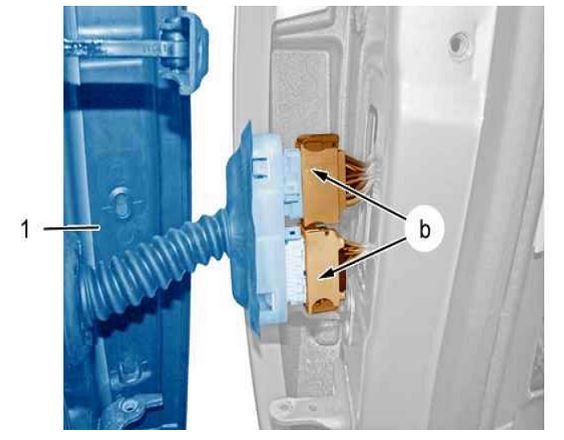

The Sleeve for the door unclips with trim removal tools here:
