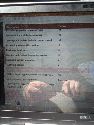

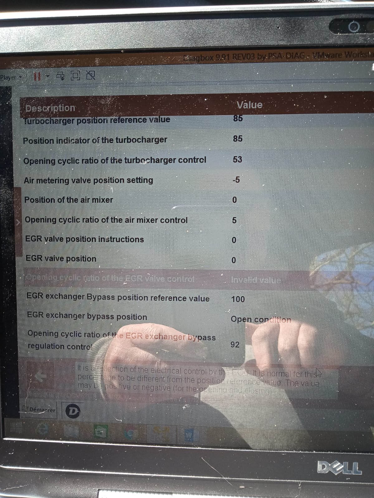

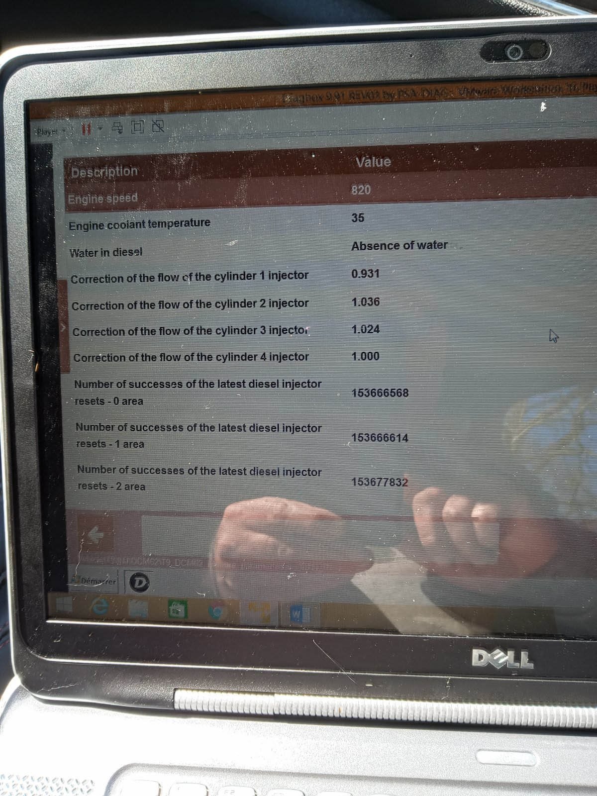

Re: Heavy Black smoke under acceleration
Hi
Thank you so much for replying.
Attached are screen shots of injectors, which from googling look ok.
And the EGR valve which I can't seem to find any data on.
Any pointers or suggestions of other data to upload? thabnk you
