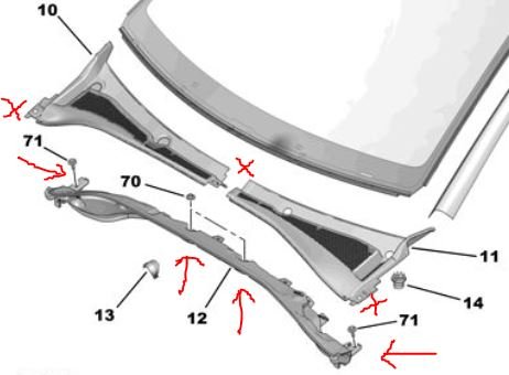

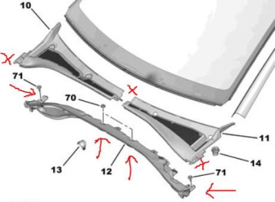

Have a look below. I have marked the 4 screws with red arrows. The top cross is the scuttle that separates in the middle into 2 halves. You have to slide these apart, but may have to remove the end parts first. What I can't be certain of, is whether the 2 outer screws in the bottom section secure the top part where I have also marked with red crosses.

GiveMeABreak wrote: 14 Mar 2022, 20:58 Have a look below. I have marked the 4 screws with red arrows. The top cross is the scuttle that separates in the middle into 2 halves. You have to slide these apart, but may have to remove the end parts first. What I can't be certain of, is whether the 2 outer screws in the bottom section secure the top part where I have also marked with red crosses.
I could not find any of these bolt that you have told me about on the diagram. The scuttle panel can be lifted up on the side which is closest to the engine. The side near the windshield is not budging it feels like it is glued onto the windshield. The windshield was changed at some point. Could it be that the sealant for the windshield was pushed out when the windshield was installed and glued the scuttle panel to the windshield or body of the car?
x 6950
Re: Unable to remove scuttle panel
That is a possibility of course, but the fixings are as per the diagram.

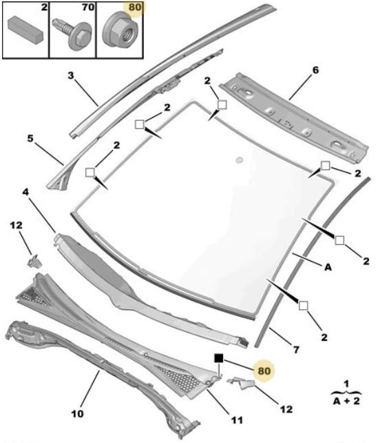

I've just checked your VIN and you have a C3 A51 which is not a C3 II, so from your VIN this is the windscreen diagram and probably why you could not match up the fittings previously. I have changed your profile to reflect the correct model as last time I must of used the later C3 instead of the A51 based on your profile and not your VIN.
As I had the VIN in use for your other query regarding the oil, I noticed the windscreen is not the same as the other diagram, so ignore the previous one I put up.
This one doesn't seem to split into two pieces and is just complete. There seems to be a nut (80) at the side, but no mention of (70), so I can only assume that is is there but part of another diagram, so be careful.
