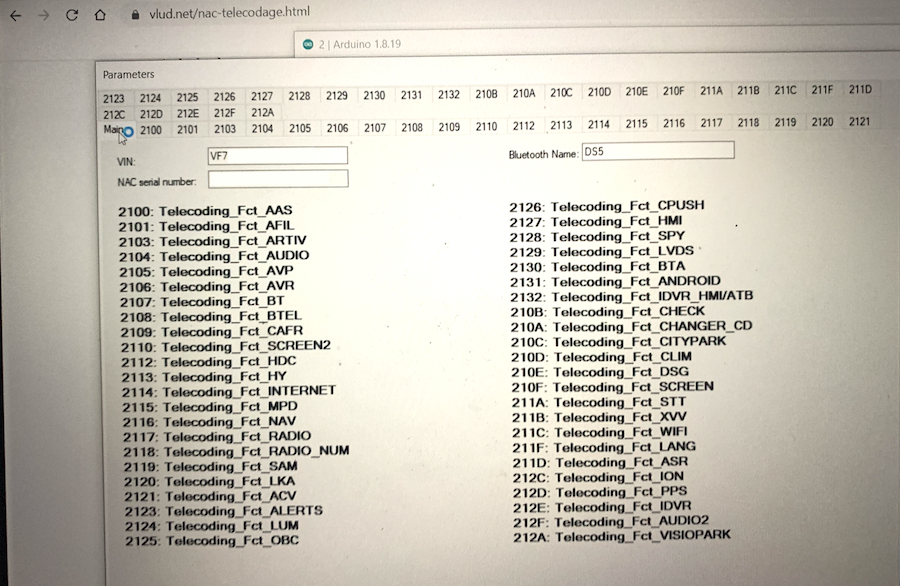

So i tried to put the NAC, all good without AC values. Do i need to have a convertor NAC2004 to NAC2010 to can see on the screes the info from clime?
Re: upgrade RT5 to NAC
Any photos of what you've got now?
I'd say you already have that 2004 - 2010 Converter (otherwise NAC wouldn't work att all)...
As for the AC: AFAIK all the factory navigation head units in 407 had just one screen (where the AC status and functions would show). But NAC can send/show those info on primary or on secondary screen, depending on the vehicle.
I think it could be configured with Arduino. You can read about Arduino tool here: https://vlud.net/nac-telecodage.html. A configuration file for P407 surely isn't listed there, but since you managed to retrofit it and it's working, some other settings alterations might be needed to have AC inf on the screen as well...
