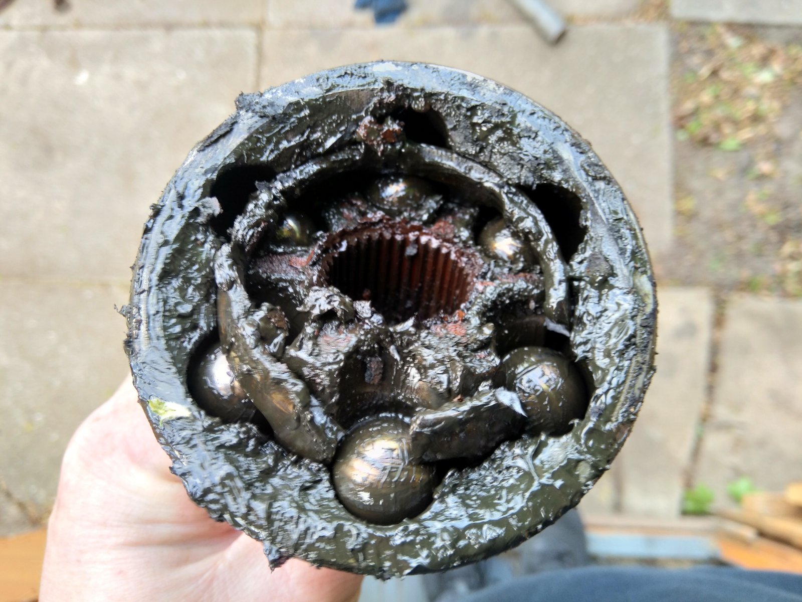

just started the job today, think I got it just in time, old cv joint came off quite easy
its insides were knackered, it didnt have long to go before it failed completely.
CV Joint was bought off ebay, the old one came off the shaft quite easy, the same side had an mot fail/advisory on its previous owner for a split boot, dirt has got in, its pointless just putting a new boot on once dirt has got in.

Yeah, think you,'ve had your money's worth out of that one! I had one go on my 307, when I stripped it off just greasy water ran out, no wonder it was shot😂
