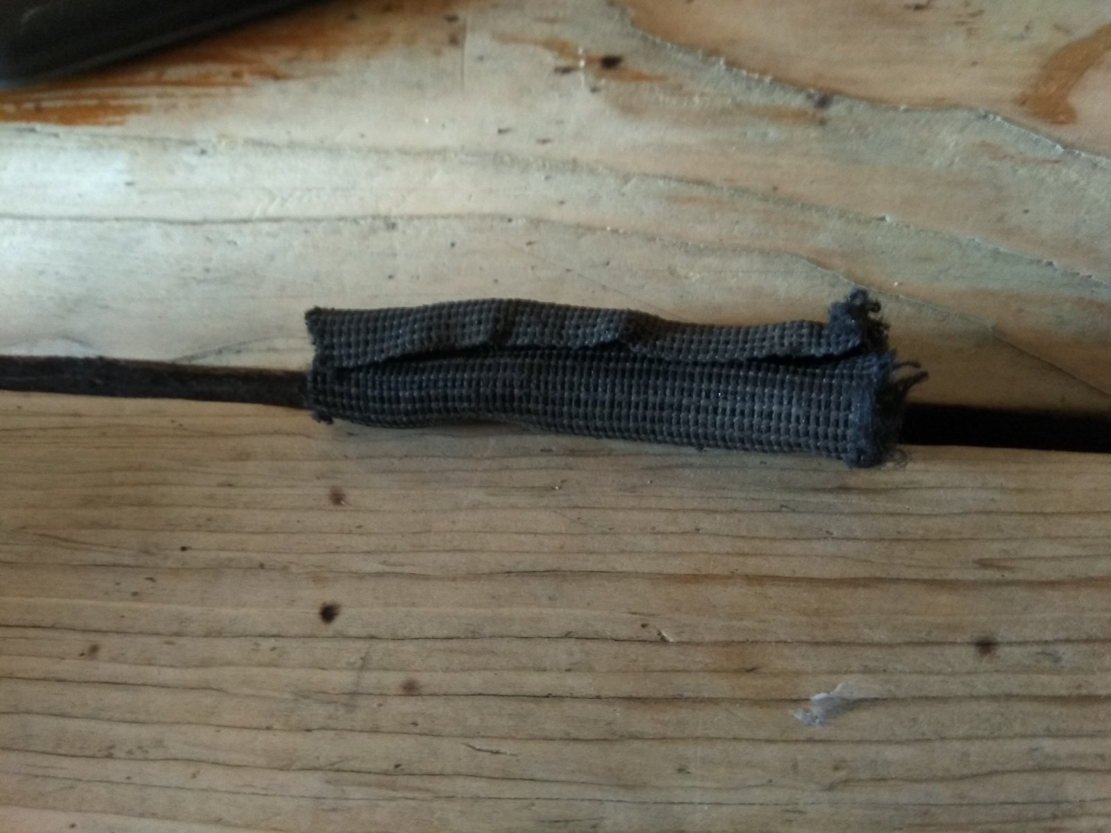

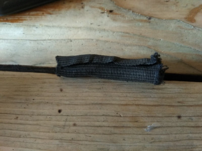

Slight update. Found this stuck where the cables clip onto the gearbox mechanism.
Jiggled the mechanism about to get it out, checked the gears without the engine running, no problems.
Went for a drive....got stuck in 2nd again. Turned the engine off and it came out back into neutral. Went for another drive missing out second, no problems. There may be another foreigner in there or maybe the foreigner has caused wear on a cable clip but no idea why this would only affect 2nd?

Update, sometimes fine, sometimes it wants to stick but if it's given a quick flick (not a hard push) it comes out of 2nd.
