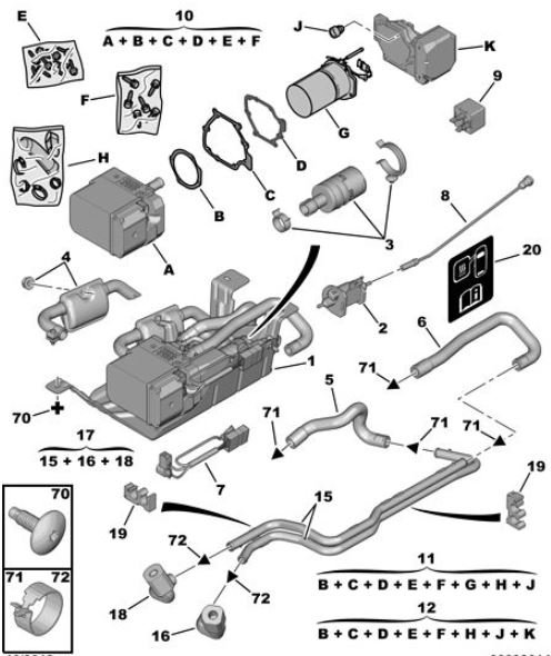

Is there a way of turning the underfloor webasto off on my 2004 C8 or do I have to put up with it scaring the neighbours when I shunt the car around without going anywhere?
- x 6954
Re: C8 Webasto. Can I turn it off?
As you can see Pete, the additional heating system is quite integrated and there is nothing I can find immediately to suggest how this would be simply switched off. I'm surprised it was actually available here to be honest as this is usually an option for colder climates like Norway and Sweden.
Seems strange to me also especially as it trips on at temperatures which are certainly not below freezing point. I will search for the control lead and unplug it, see whether it upsets the ECUGiveMeABreak wrote: 05 Mar 2022, 22:49 As you can see Pete, the additional heating system is quite integrated and there is nothing I can find immediately to suggest how this would be simply switched off. I'm surprised it was actually available here to be honest as this is usually an option for colder climates like Norway and Sweden.![]()
As far as I know all diesel UK spec C8's had a Webasto as standard.
Yes you could just unplug it, if doing this i would make sure you seal up all the connections on both the harness & the unit itself as i imagine they would rot pretty quickly due to being located underneath the car.
Other options are you could un program it if you have access to Lexia or Diagbox, If i remember right this is done in the injection ECU menu also. Option2 would be to remove maxi fuse 3 that is located underneath the under bonnet fusebox.
Thanks for the info, thought I had (as normal) bought the only specimen!!wheeler wrote: 06 Mar 2022, 08:41 As far as I know all diesel UK spec C8's had a Webasto as standard.
Its mainly a nuisance just at the moment, while I am shunting the car back and forward to work on it. Would removing maxi fuse 3 affect anything else?
No idea, only one way to find out
Not sure if anything else is listed on that fuse.
