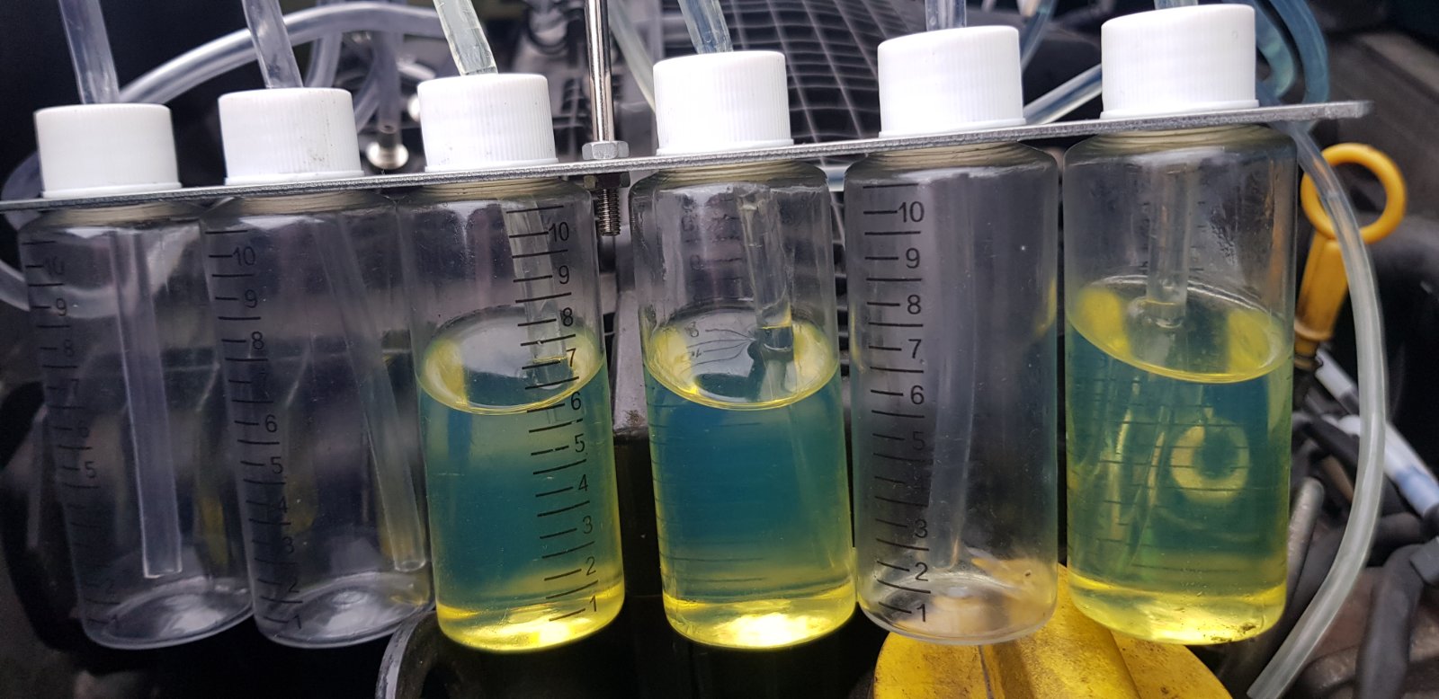

Well i didn't know my neighbour still had a problem with starting this kangoo as I'd heard nothing from them for some time, unfortunately it still won't start & has in fact become harder to start. The intention now is to replace the primer as it won't go hard after numerous pumps, it'll be a difficult job as the pipes run down underneath the vehicle and i don't think it has a pump in the tank so bleeding it could prove to be impossible 😖. Ive also carried out a leak off test which threw up an issue, 3 bottles filled ¾ of the way in about 30-40 seconds and one remained empty. I did the test twice and got the same results, I'll do it again before commencing any further work but i don't know whats causing this, poor feed to one injector? three injectors leaking back too much? fuel pump failure?... it doesn't look good anyway.
