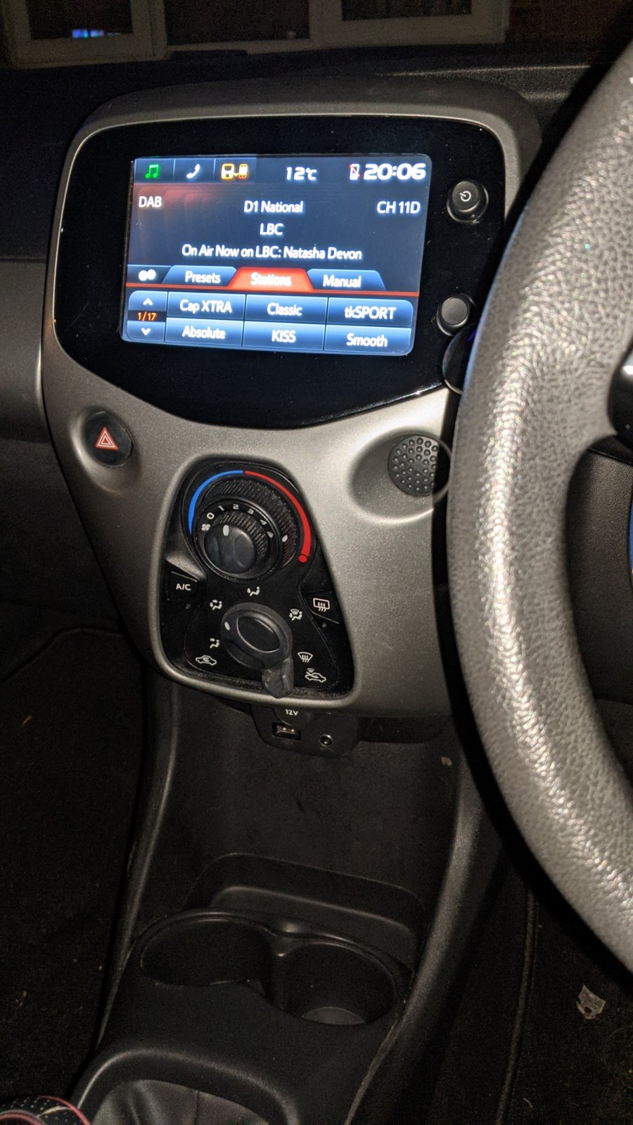

Hi everyone,
I hope I could maybe get some help on this? I bought a used 2015 C1 which had issues with the USB and have had the head unit replaced under warrenty and now the USB is working. I can plug in a USB stick and it finds the music on it and it will now charge a phone from the port.
In the manual it says that it supports MirrorLink and AppleCar but doesn't implicitly say that it does for Android Auto (even though, I think it uses the same protocol as MirrorLink?). I saw on youtube a video from Citroen saying that the C1 7" screen does support it but maybe thats because its newer? I've tried plugging my phone into the port and pressing the connect button on the screen but after showing the trying to connect screen nothing happens after that.
Does the car support Android Auto or would it only be AppleCar? If it does support both, how do I actually get it to work?
Thanks for any help.
