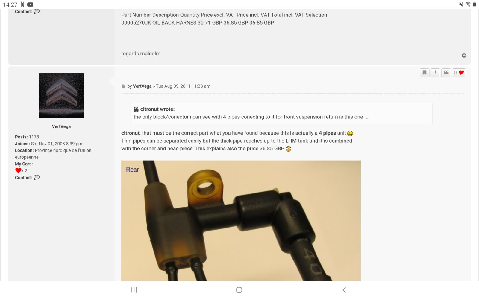

Looks like this maybe. I bought this part at citroen but was 10 years ago so don't know if they still have them.(I did a screenshot cos I can't do a link)
This website might help
http://xantia007.free.fr/19_circuit_ret ... 5270P3.php?
Fred, a silver 1998 1.9TD SX Xantia.

That part is reproduced and available from dr Xantia https://www.drxantia.com/index.php/en/p ... B&keyword=
