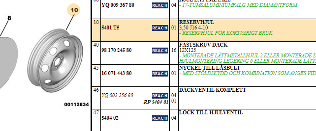

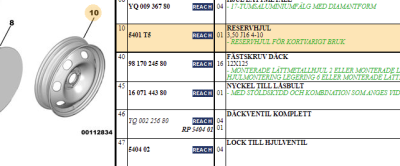

C5 x7/C6 have five bolts, 5/108.
Your C3 Aircross is 4/108.
If you have the correct size tyre the same diameter rim isn't really nessesary on a spare wheel.
There is a spare wheel listed on servicebox

Hi folks
thanks for the responses.
Yes I am aware a full size wont fit where the "get you home " one sits I just feel more comfortable with a full size when going on a long trip.
I will check the number of bolt holes on the "spare" could have sworn it was five! Nope its 4 just like you said!
Oh will stick with the toy "spare" then
many thanks all!
