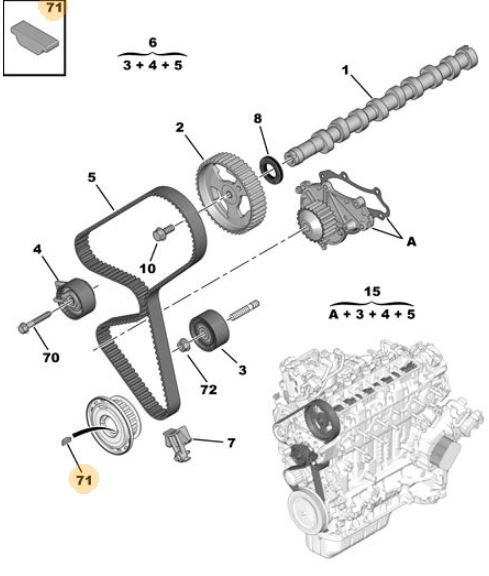

It's very possible they have replaced the timing kit and a few other bits Mick. May be worth confirming if that is the case, as it would save quite a few £s if the timing kit, pulleys and all have been replaced.
Item 71 is the CRANKSHAFT COTTER PIN, so that may well be the pin being referred to.

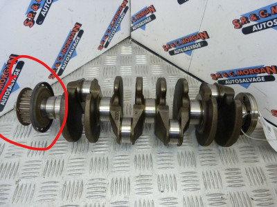

Right so its what I'd call the crankshaft pulley!!
It does say motor kit on there too so it is possible they used the standard timing belt service kit. I will give them a call tomorrow and check.
