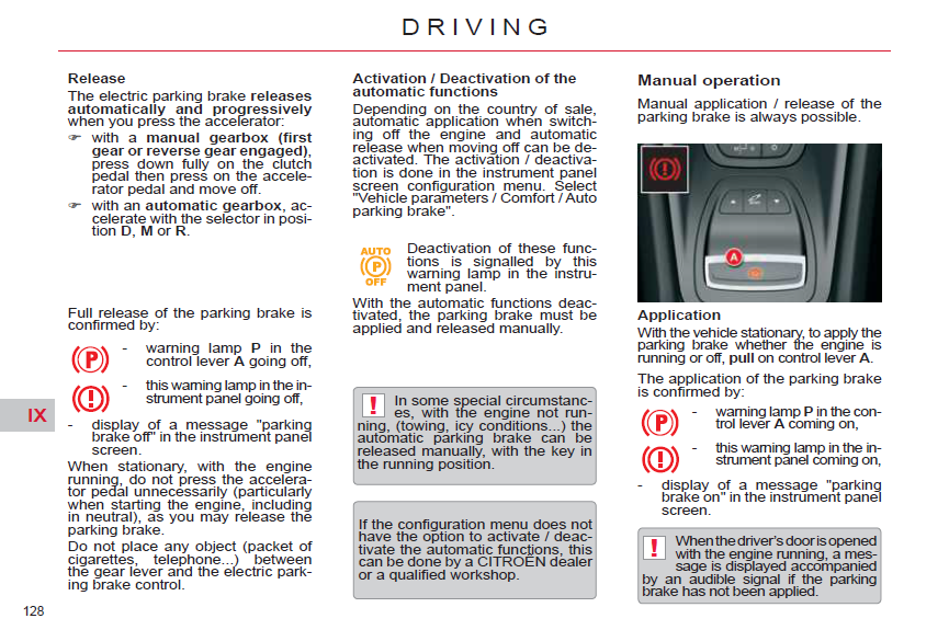

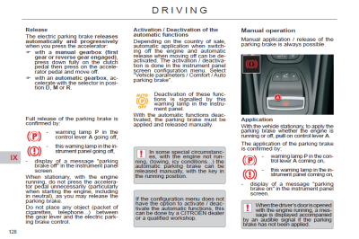

According to my handbook it can be switched off without using Diagbox.
If you don't have this option then it might not be available in your country. In which case a Diagbox will probably be needed.

It can't be done on Diagbox, as there's no option to switch this off as far as I can see from the BSI configuration - it's part of the EPB and ESP Operation. The only way was to use the in-car dash menu, BUT, if I recall, as happened to me, the option was also removed on later BSI software updates, so if you've had your BSI updated then the option may be removed from the menu. There was another issue with a configuration of the locking function options going missing - which I had to restore.

My car doesn't have option to be turned off via dash menu, that's why I'm asking for possibility to use Diagbox, as is written in manual - "....this can be done by a Citroen dealer...".
