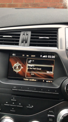

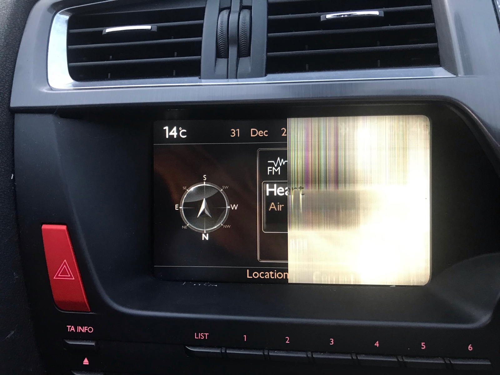

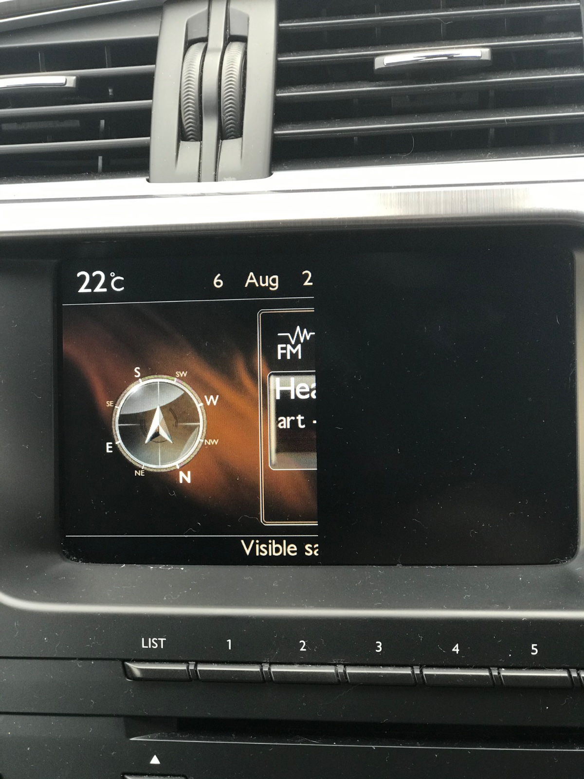

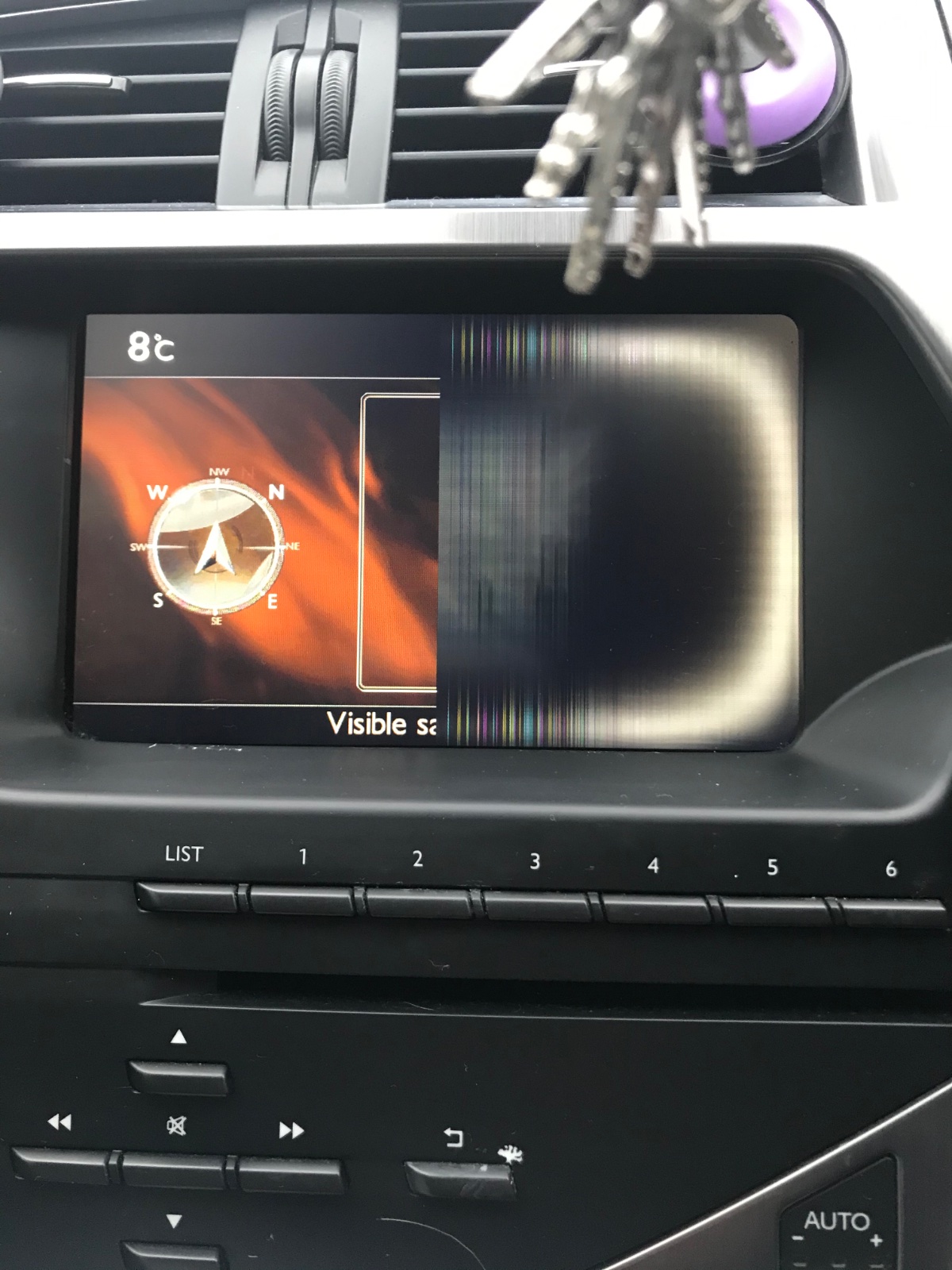

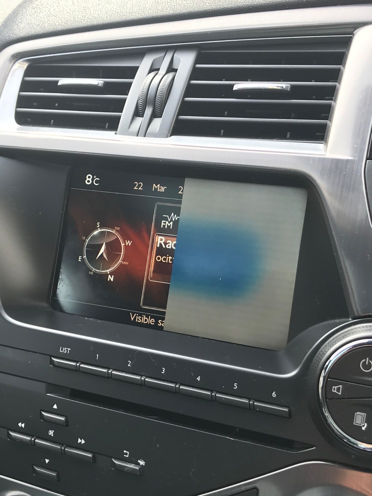

Having problems with my LCD screen. One day half the screen just randomly disappeared. Had been for a couple years now. Had a few people look at it all said they whole screen needs replacing. However, when getting a bulb changed in my front lights, when turning the engine back on the screen appeared like nothing had happened. I mean it was faulty for at least two years. It lasted a whole week with the full screen. It has since disappeared again. Any clue if it can be just a faulty connection? Been quoted £1000+ for a new screen

I can also post photo what the screen looks like

That's is very likely a new screen required, as per the looks of it and the official diagnosis from the description / pictures where parts of the display are not showing.
I assume the reversing camera is also showing similar symptoms when activating reverse gear?
You have the RT6 system and a new one is not just under £1200 retail inc. VAT. You could look to getting a second hand one on ebay or other places.
However, I should point out to you that when checking your VIN, your vehicle has an outstanding after sales campaign recall due on it. I can't tell you exactly what, but I suggest you contact Citroen directly and tell them you've been advised that there is recall that needs doing. They will ask for your Registration or VIN. The work won't cost you anything, but I'd get it booked in as soon as you can. They'll be able to advise what it is when you call them.
