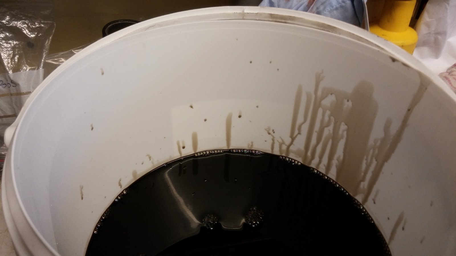

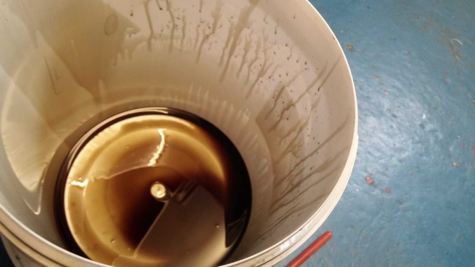

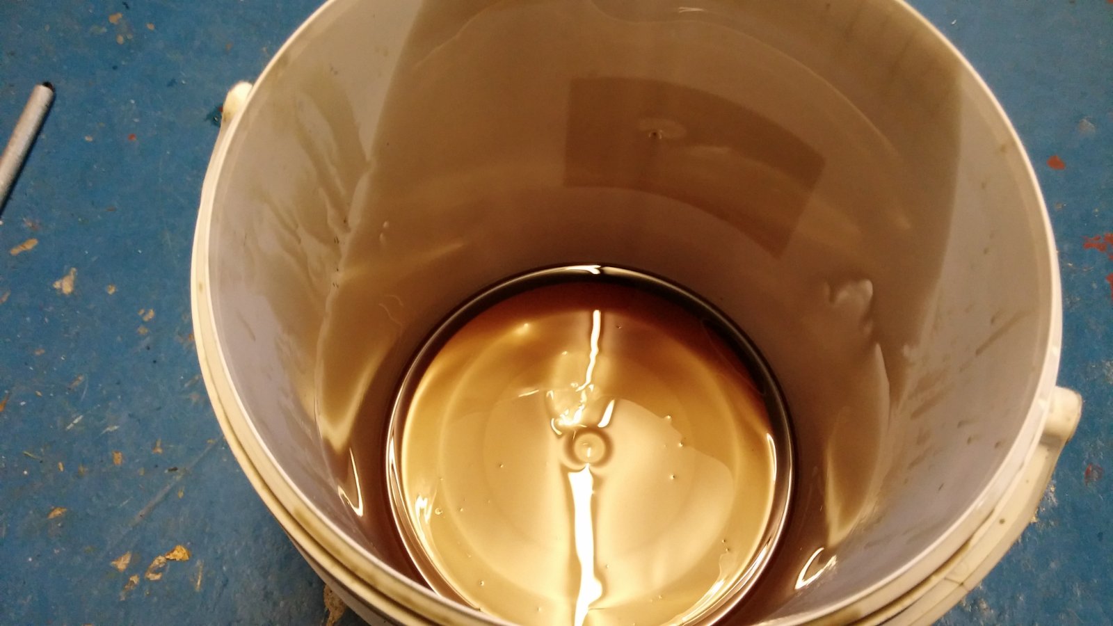

Re: Automantic not working!
Not sure what you are defining as brown & red, these are photos of the oil drain bucket of my first oil change, look similar?Theflyingpostman wrote: 05 Feb 2022, 15:55 I have look the fluids is level, but the colour is brown, I am sure the colour should be red?
Yep my colour is same on the first picture, I went google for Citroën C5 automatic fluid is bright red. I think it need to change cos the brown colour might, the reason that my auto is not working well.

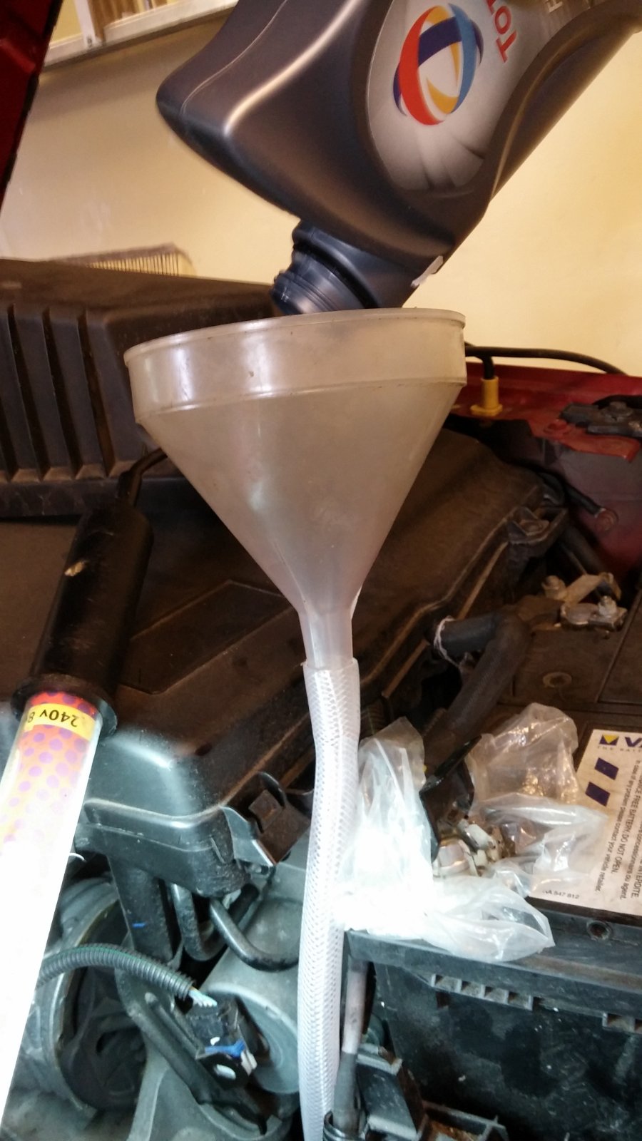

Best, read other posts on this forum before you start, and give yourself a clear day, it shouldn't take that long, but you never know.
Also, here's a tip on how to fill, the reinforced pipe that is forced over the funnel has a piece of 15mm copper pipe in the other end, this fits snugly into the filler hole.
