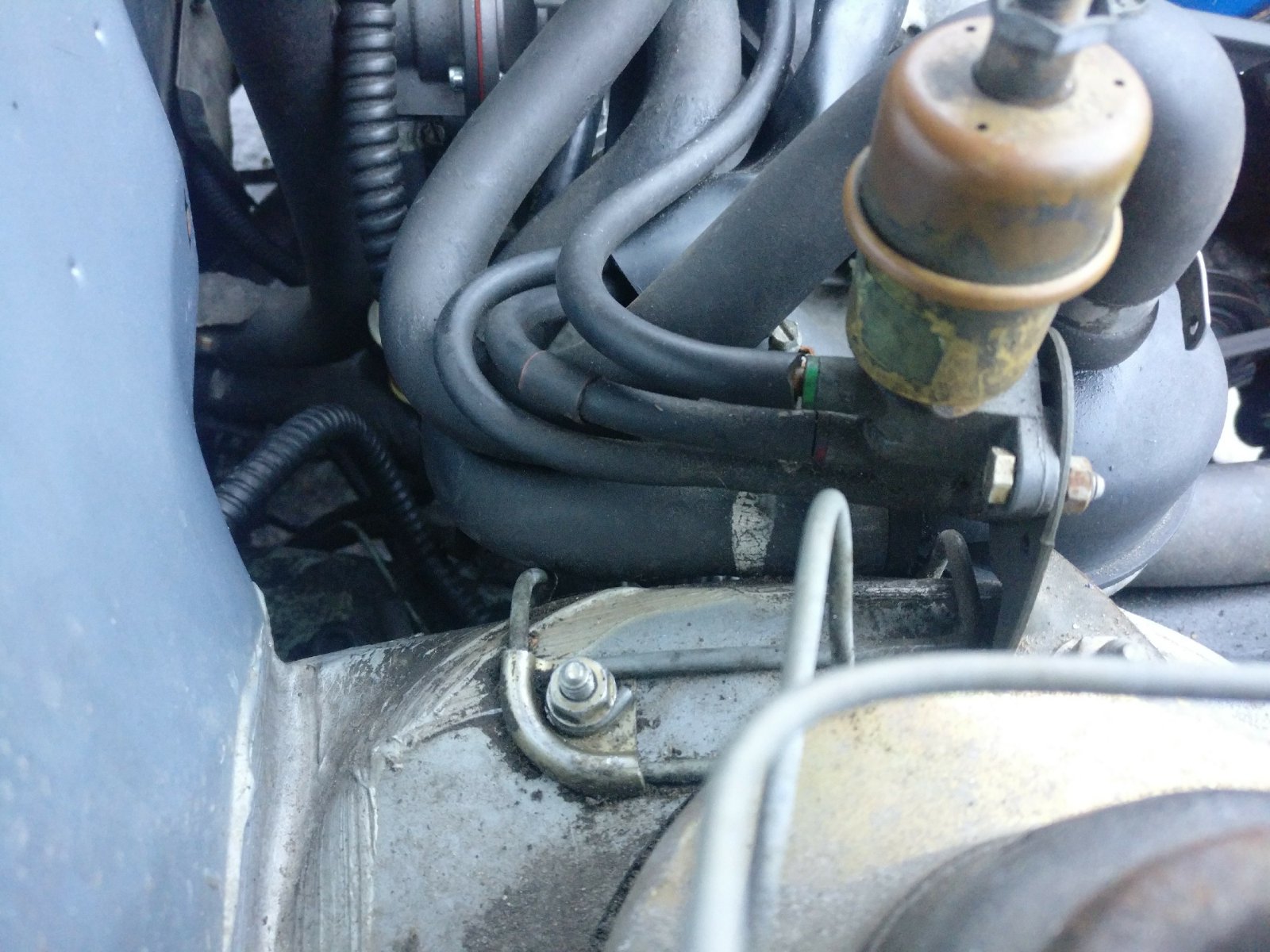

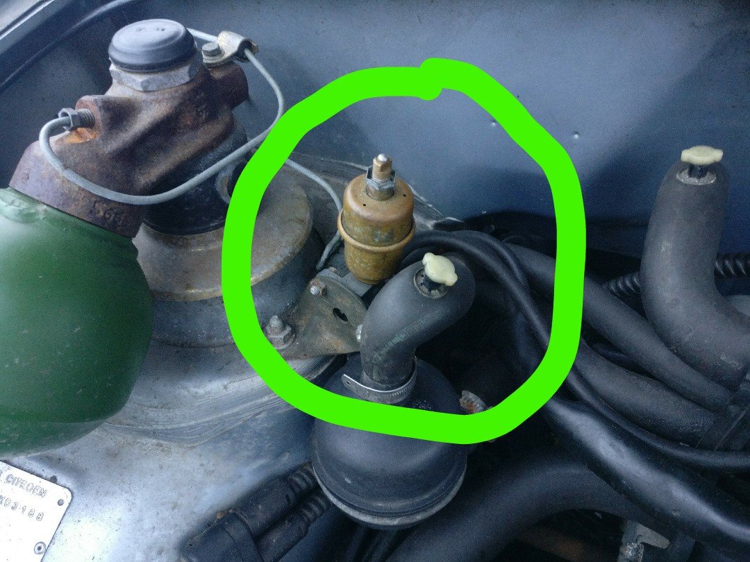

Hello.
Can someone tell me what is the name of this device in my engine, and what it does.
Three vacuum pipes are connected to it.
Thank you
Thank you

Re: What is this device in my BX14RE?
It's a de-aerator, part of the fuel system.

Thank you for your replies.
I hade a closer look in the engine earlier today.
All hoses that are connected to that device comes from the carburetor. So it must be air, or mixed fuel-air that is going through that device. Or what do think? (as you see on the picture the hoses are without clamps, which should have been there if these were fuel hoses).
The fuel hose goes from mechanical pump through filter to carburetor.

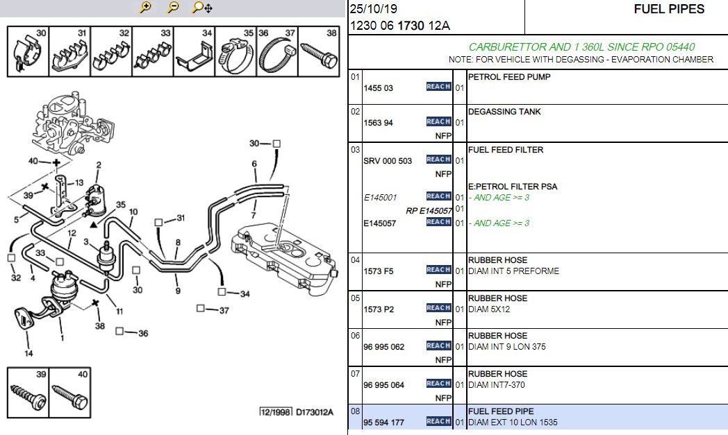

Looks like #2 (de-gassing tank) here...
? Click to enlarge
? Click to enlarge
Thank you for your effort.
But the de-gassing tank is not similar to the device on the photo.
And again the fuel is not passing the little device in my engine. In the picture you posted, the fuel passes through the de-gassing tank.
Can you possibly find another schematic, for hoses connected to the carburetor, or vacuum hoses.
My carburator is SOLEX 32-35 TACIC

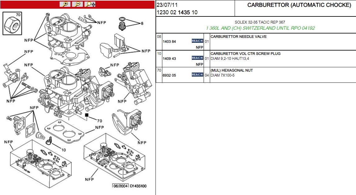

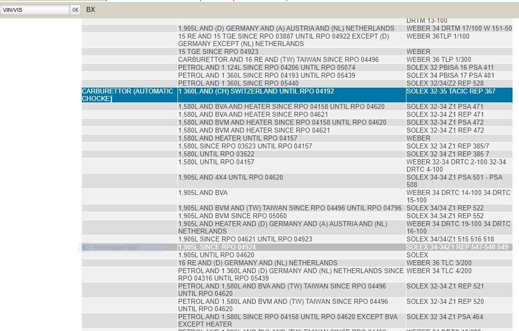

Doing a search of BX > fuel systems throws up JUST ONE entry for Solex 32-25 TACIC, which shows helpfully as Switzerland... and this diagram... The triple pipework is not shown - again not helpful - and neither is the "3-port" component.
