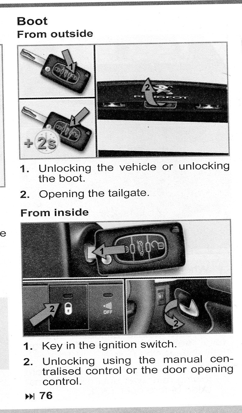

My 2007 Peugeot 207 CC came without an owners manual- mind you it also came without an engine that worked. I have subsequently downloaded a pdf copy but it's not the sort of thing you casually browse through like a book. But recently I came across a description of a second way of opening the boot that did not involve the button on the remote- see below
I have tried putting the key in the ignition and pressing the lock button to no avail. Eventually the alarm gets upset. I also tried opening the door without effect.
When I think about it you probably would not want the boot to open when you got out of the vehicle with the key still in the ignition (and switched off)?
I'm puzzled.
more than one way to open 207 CC boot?

I hope you’re not expecting the boot to physically open. That’s just like most PSA vehicles in that pressing the button on the dash just unlocks the vehicle, but doesn’t open it.

Pressing the centre button of the fob for 2s will unlock the tailgate/boot on some PSA vehicles. Our X7 Tourer has this for instance. But I believe that the saloon does not. Our 308 SW doesn't. Check your key fob*, if the pictogram shows the boot opening then that's the giveaway. On our 308 the centre button puts the headlamp dipped beam on and the pictogram shows this.
What I don't know for the CC models is whether operating the fob button will actually operate the opening motor of the roof.
*Only if it's the original fob of course. If it's a replacement it might be incorrect.

Note the use of the terms "unlocking" and "opening" in the instructions above. Unlocking allows the boot lid to be opened using the button on the boot.

Unless the button on the remote actually opens up the bootlid for you then its one of the most pointless 'features' on a car. I cant think of any advantage of having a button that just unlatches the boot, why not just press the car unlock button? You still need to manually lift the boot anyway. It's probably the biggest cause of people locking their keys inside the car too as when you use these buttons the rest of the car remains locked so when you sit the keys down along with your shopping & close the boot down your keys are locked in there too.

Re: more than one way to open 207 CC boot?
Convertibles that need the boot to remain locked when the car is left with the roof open probably have a different security strategy to normal cars. I think this is the reason why in my MGF that the bonnet opening latch was in the boot and the boot could only be opened with a key. Where it gets confusing for me with the 207 CC is that the strategy appears to depend upon whether the car is in the cabriolet configuration or not. Also, on mine there is no boot latch as such. There is a rubber grommet in the appropriate area but no feel of anything tangible behind it. And certainly nothing that results in opening of the boot. Pressing the middle boot button on the remote results in "unlocking and partial opening of the boot". What I found comforting in the manual (p.76) was: .."if you inadvertently leave the key in the boot, press the manual centralised control A immediately to unlock the boot and retrieve the key." I tried this (without putting my keys in the boot!) and it worked. Mind you, you would not have wanted to have locked the car doors prior to this?
