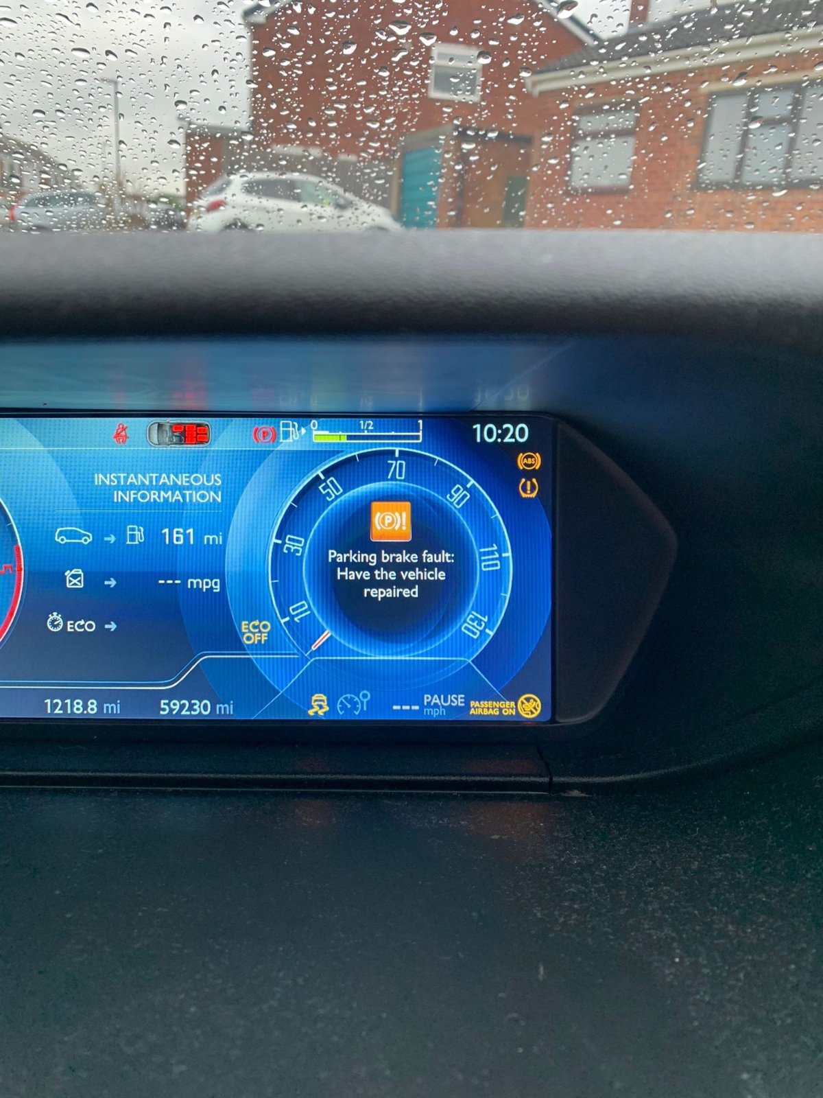

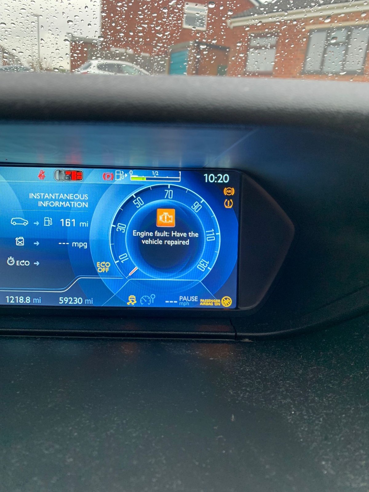

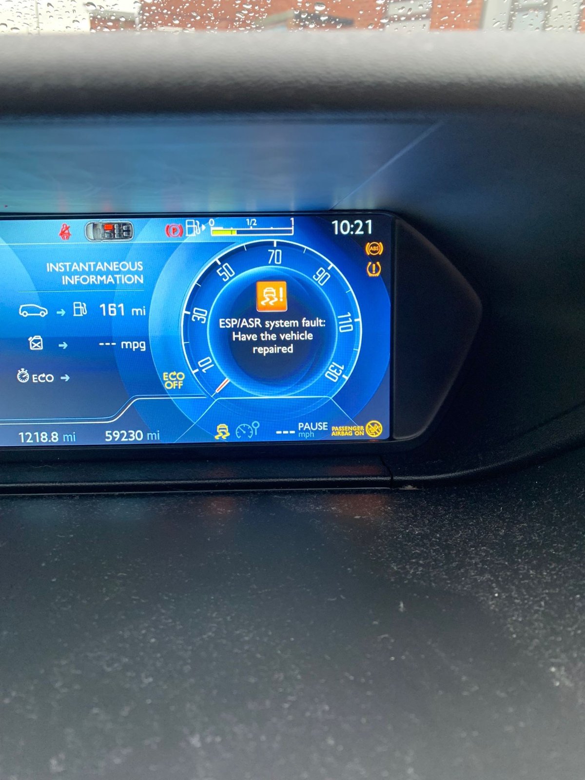

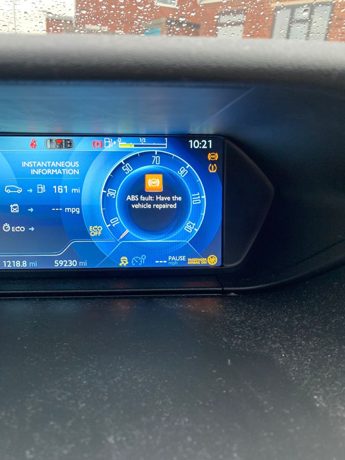

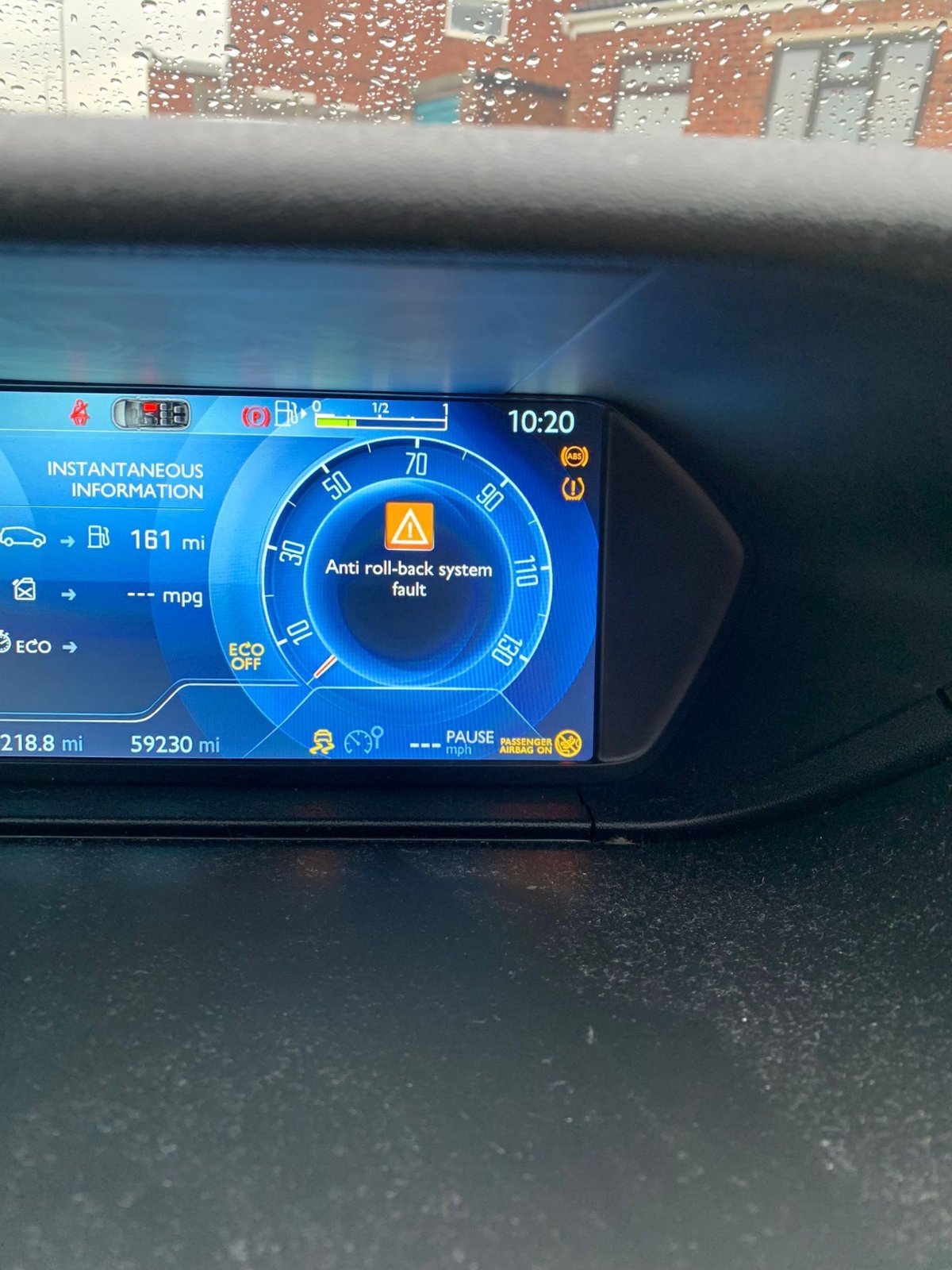

I have had issues with my C4 Grand Picasso since I had the clutch replaced. It started with an engine fault and the ECO was always off, however last Thursday I started the car and go the below messages:
1.Parking Brake Fault have the viehcie repaired
2.Engine Fault have the vehicle repaired
3.Anti Roll back system fault
4.ESP/ASR system fault have the vehicle repaired
5.ABS fault have the vehicle repaired

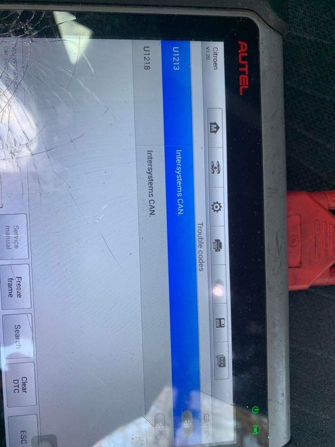

I have had it plugged in and got U1213 and U1218
Would anyone have any clue what could be causing these issues?

My first thoughts are that whoever has done the clutch has upset the ESP system. 'U' codes denote communications problems with the data networks
U1213: Fault with the information sent by either the ABS/ESP ECU or the electric parking brake ECU: Value received incorrect. I assume you have the piloted manual gearbox on this vehicle. Post up your VIN (automasked on post submission) it will help us. This can be a fault with the piloted manual gearbox sending information to and from the handbrake ECU and / or the ESP ECU.
U1218 is a fault with the CBSI receiving invalid data, usually down to connectors or the intersystems CAN network.

I'd take it back to them as they have clearly admitted the damage and this is likely another offshoot of whatever they have done. Once you have given them a chanve to fix it and it is still not correct, you will likely have a case for negligence.
Tracking communications faults can be difficult as it really needs proper equipment for testing multiplexed CAN systems in order to try and localise the fault. Either that, or get them to agree to pay for the diagnostic and possible repair / replacement parts at a Citroen dealership which has proper equipment to diagnose and test. You're the victim in all this after all.
