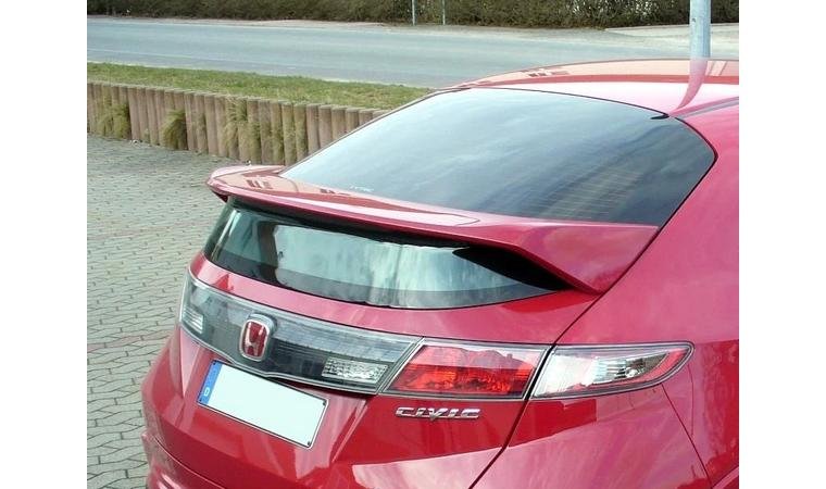

Problem with the Civic is mounting the rear camera. It won't fit in the place that it should, not enough space where the boot catch is. I can direct it through the glass under the 'spoiler' but it may distort the image.
Not mine but similar. See where the stupid reversing lights are?
I had seen one in a YT clip that was good but American. Similar but not quite the same available here, have one lined up on Amazon. Need to procrastinate a while before releasing the funds for it.

What about where the rear number plate lights are - some of these replace one of the 2 lights with the camera - this type are designed to replace one of those.

Will likely get pulled for a light out.
Going to try a camera through the tailgate when I get my car back.

No, you don't lose a light. The type I've seen for a PSA vehicle has a combined camera and number plate light in one unit. Maybe available for your car?
