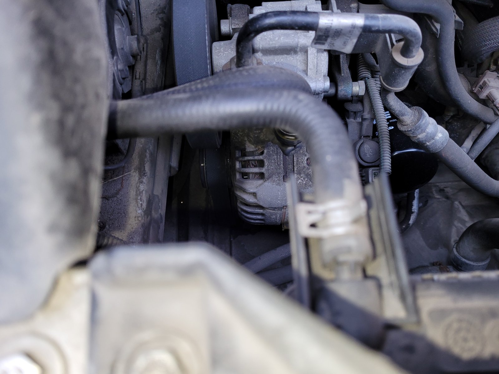

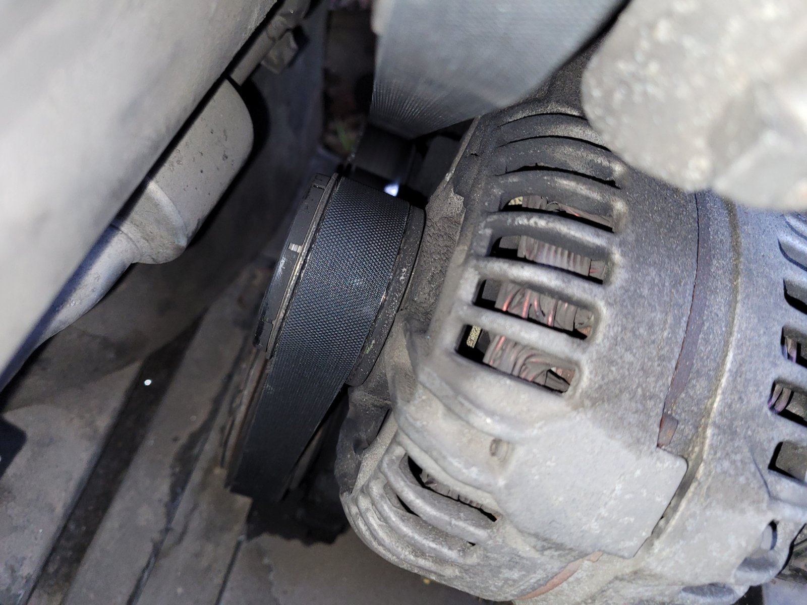

Re: Strange electrical problem - no charge while on idle
Just check that the alternator has the correct size pulley. It has been known for an over-size one to get fitted, which results in insufficient alternator output at idling.
Normally, the alt pulley is about 1/3 the diameter of the crank pulley, to give c3000 alt rpm at c1000 engine rpm at idle.
If idle speed is low, this will aggravate the problem.
Check that battery is receiving around 14.4v minimum when on charge from the alternator, major accessories off.

I cannot compare it with the crank pulley as I cannot see it from above so maybe only from bellow, on a lift.
I took some pictures of the alternator, maybe it is apparent it's not the correct size.
Battery is receiving 14.4 when there is no load or I rev the engine at about 1500 - 2000 RPM.
Thank you!
Thank you!
