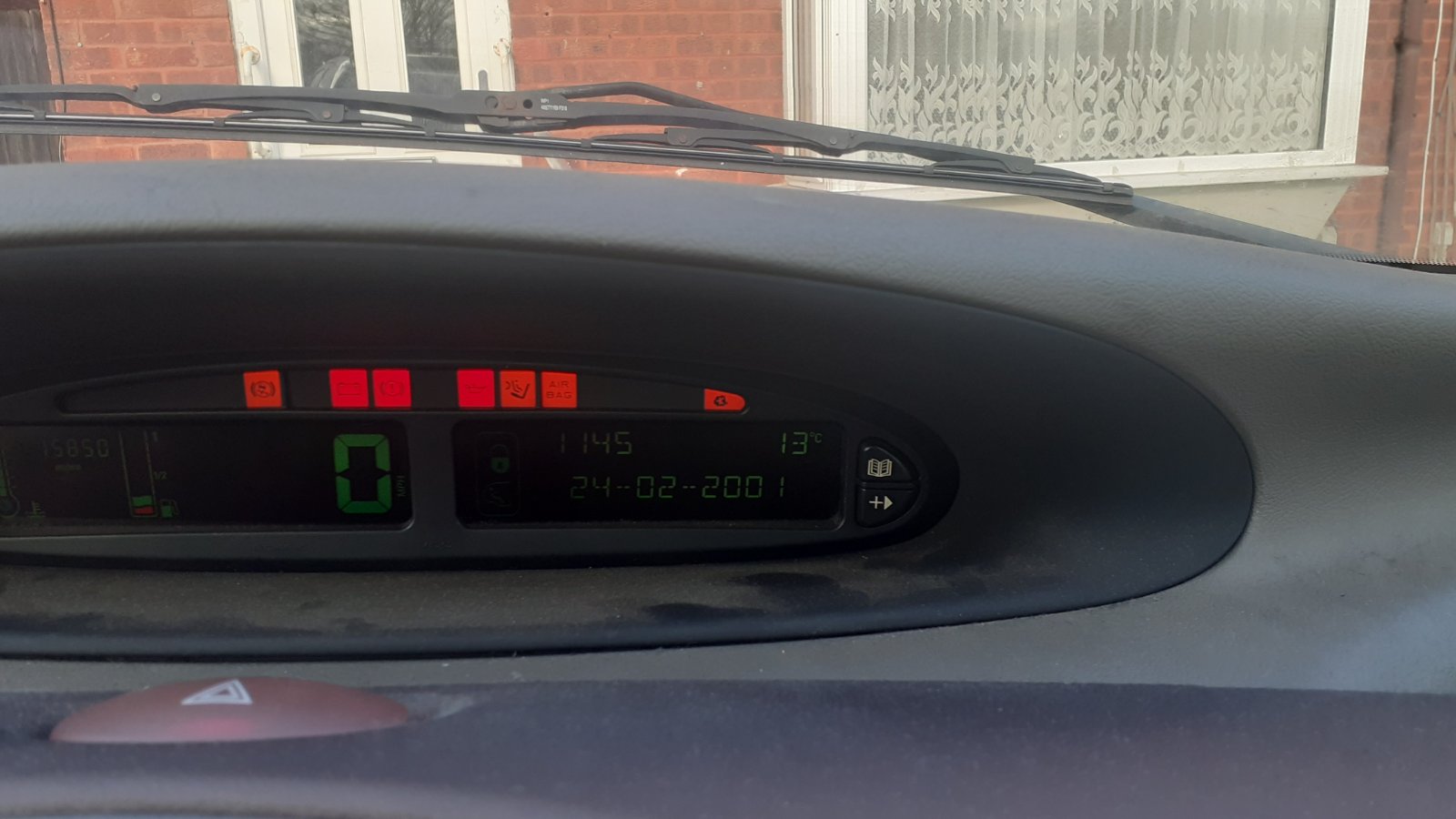

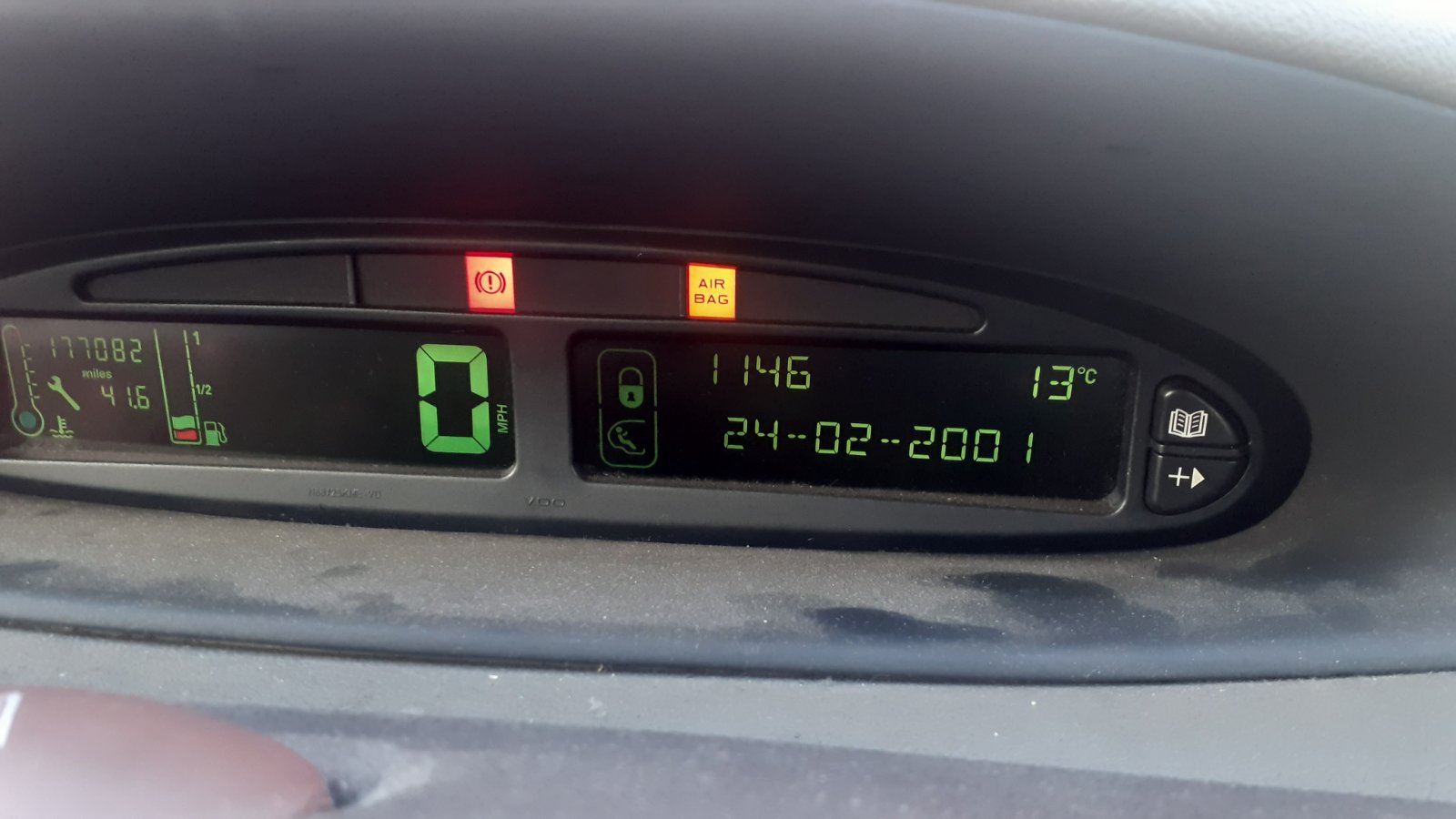

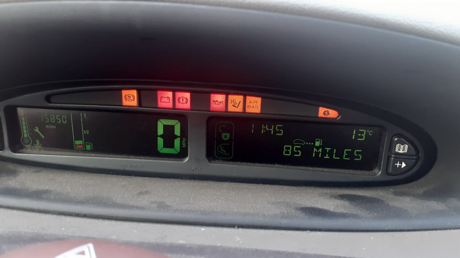

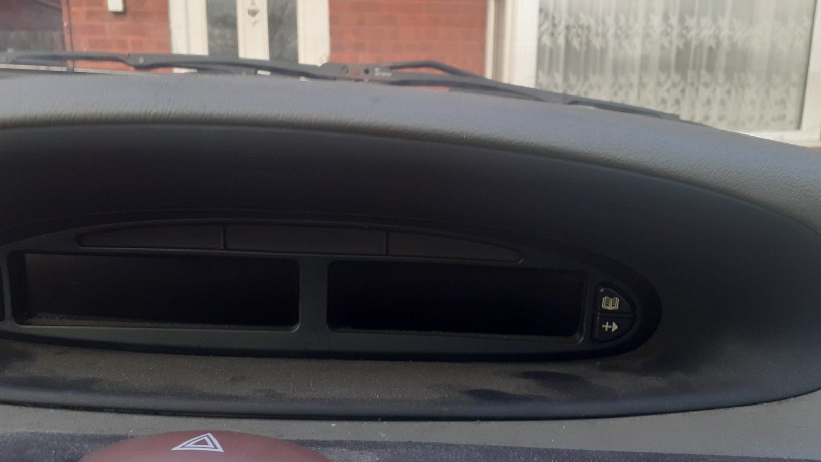

I have a 2003 1.8 petrol Citroen xsara picasso. Recently i have been having a few problems starting the engine. When i turned the key all the dash lights would come on but when i turned the key to start it, all i would get is a click. Try it again and it would start instantly. Turn the engine off and try it again and it would start instantly. But this problem has been happening all the time until this morning i had to try about 6 times to start the engine. I did notice on my dash i usually have it set to petrol range but when i did mange to start it, was displaying the date instead of range and the back window wiper will go off on its own i have noticed this on a couple of occasions. Is this battery or starter motor problem or is it something else or is this gonna be the comms unit on its way out.

Re: Starting the engine
Normally a clicking sound can be starter motor related. As the brushes wear over the years, they become stuck in one position. In an emergency, you can tap the starter casing gently with a hammer to get them to drop back down, but it means the starter needs replacing or repairing.
If the battery is failing, it may have insufficient capacity to hold as much charge as it once did, so the strain when starting can often deplete it. It may be worth testing the battery, but anything over 5 years is pushing it and more noticeable in winter months, where there is a greater demand on the battery.
I suspect as you battery is under the passenger seat that the battery terminal connections and leads are in general good order, so those are my 2 prime suspects, car battery and or starter motor. You can get electrical issues with a weak battery, so I would ignore the rear wiper issue for the moment until you've looked at the other issues.
