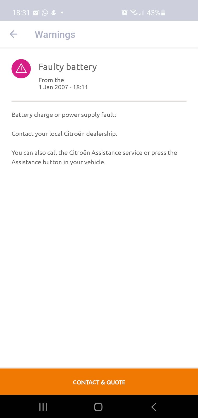

I replaced the battery on my C4 Picasso yesterday after a warning on the dash was saying "electrical circuit fault have vehicle repaired" and the app was saying faulty battery.
I put the new battery on the car and followed the BSI reset details but the car is still showing the same fault code and now the alarm is sounding when I lock it.
What have I done wrong can anyone provide advice ?

Did you follow this guidance?:
BSI Reset / Battery Disconnect / Reconnect Procedure
If so, then you may have a power / supplies issue that needs some proper diagnostics.

Did you check the charge rate from the alternator, this should really have been done first, There may have been nothing wrong with the battery but it could be a charging issue.
