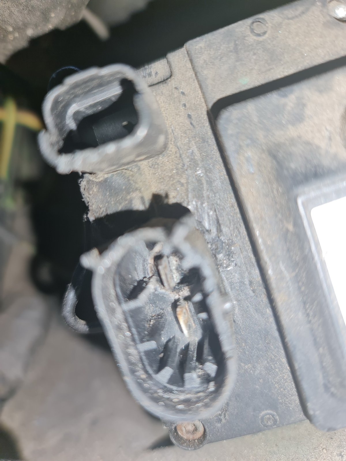

Re: Citroën C5 suspension issues
My C5 did the exact same thing.
The probelm was the electrical connector that suplies the pump with electricity.
It was really stuck and rusted (possibly fused to the pins of the pump because of poor contact). Today I finally managed to take it out after some 3-4 attempts in different days.
Cleaned the contacts as well as I could and now everyting is working.
Hope this helps
