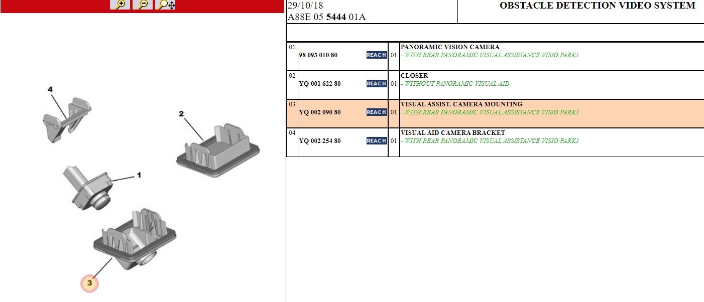

I take it you mean this bit? the non camera models have a blank in place. Looks like you would need to change it for the camera mount type.
I have no idea if the wiring will be present or not for it already.

My rear camera fell out (broken retainer clip) and part 4 have in the diagram I have no idea how it fits back on.
I have ordered a replacement front plate to hold the camera in.
'Diagram from Wheeler with 4 parts to camera drawing'.
Can anyone help me with this please
